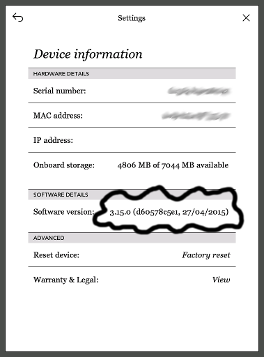

These patches are completely unofficial, so if you have a problem with your patched device don't complain to Kobo. The best place to ask for help is in the instruction thread above for the firmware version you are using.
(I refer to these as the Metazoa patches because most were originally created by metazoa at www.the-ebook.org, and as a way to distinguish them from other patches and mods.)

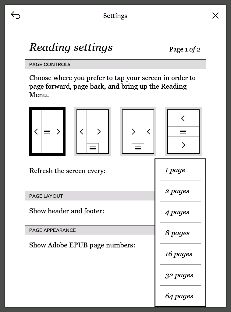

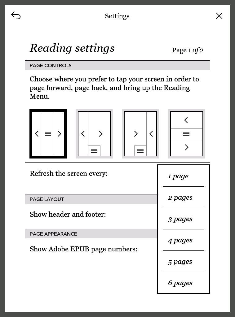

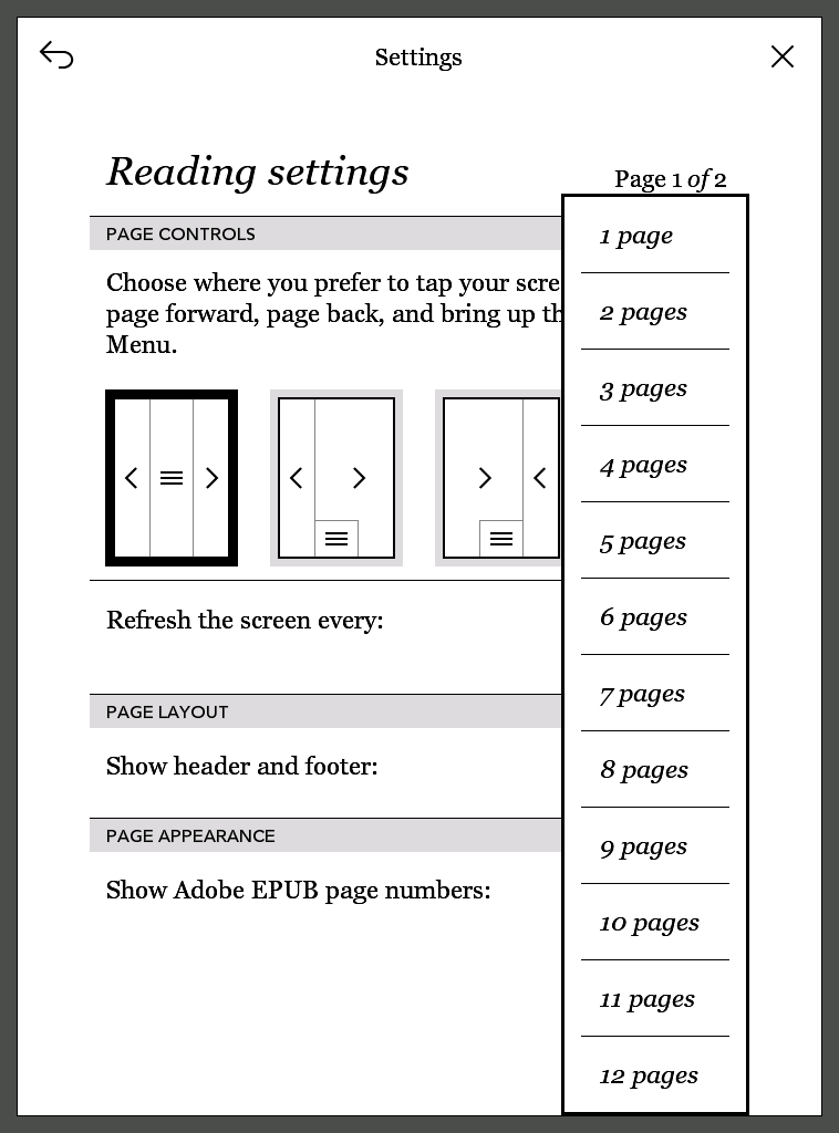

Custom page refresh options
The unpatched firmware allows the page refresh interval to be set from 1 to 6 pages. It is also possible to edit the numPartialUpdatePageTurns entry in the [Reading] section of the device's configuration file to change the value to something larger than 6.
The `Custom page refresh options` patch allows the Reading Settings menu itself to be changed, so you can select from a custom set of values without the need to edit the configuration file. There are two patch alternatives: an arithmetic progression (default 1,2,3,4,5,6,7,8,9,10,11,12); or a geometric progression (default 1,2,4,8,16,32,64).
The screenshots attached (Glo, 3.15.0) show the first page of the Reading Settings menu, with the Refresh menu popup activated. From left to right:
1. Unpatched.
2. Patched, alternative 1 (default).
3. Patched, alternative 2.
ID:	137999   Click image for larger version
ID:	138000   Click image for larger version

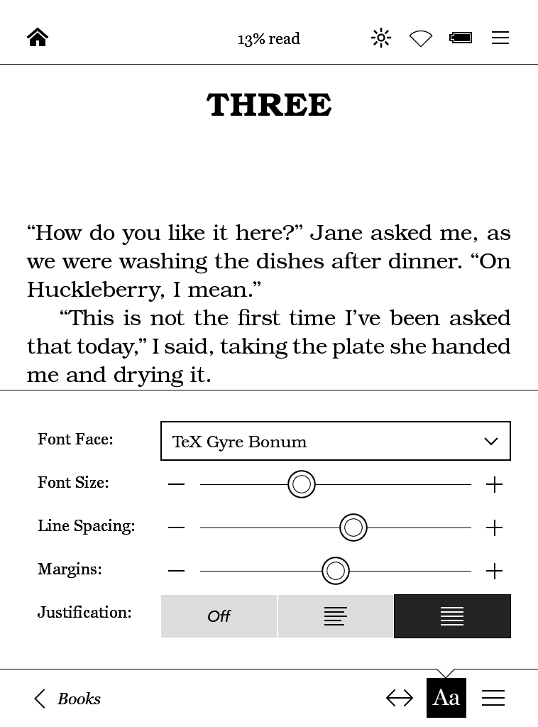

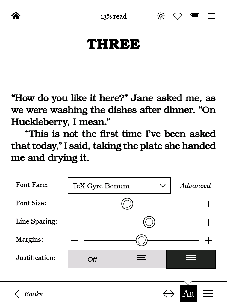

Freedom to advanced fonts control

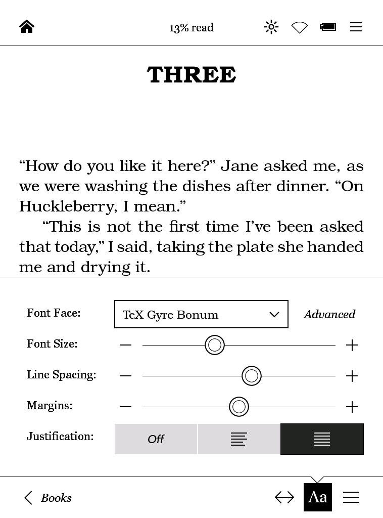

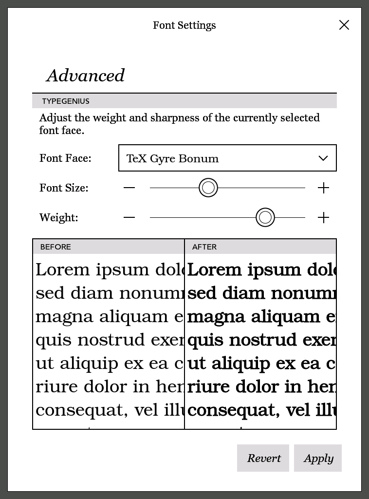

The unpatched firmware restricts the advanced 'TypeGenius' font menu (which allows adjustment of font weight and sharpness) to a subset of the built-in fonts. The `Freedom to advanced fonts control` patch removes this restriction, making it available for sideloaded fonts too.
It is possible to set the weight and sharpness for sideloaded fonts without patching by adding readingFontWeight and readingFontSharpness entries to the [Reading] section in the device's configuration file. For example, readingFontWeight\Georgia=0.8 sets the weight of the Georgia font to the maximum value selectable from the advanced menu slider. This patch allows the convenience of adjusting these settings onscreen without the need to edit the configuration file.
Both OTF and TTF format fonts can be adjusted, but the adjustments might not take effect in the EPUB reader unless the font is in TTF format. In recent firmware versions this patch can no longer be used with Japanese language books or Japanese locale settings.
The screenshots attached (Glo, 3.15.0) show the font options for a sideload TTF font used in a sideloaded EPUB book:
1. Unpatched, Aa menu.
2. Patched, Aa menu; note that the 'Advanced' menu is now available for this font.
3. Patched, Advanced menu, weight/sharpness increased.
4. Patched, after tapping 'Apply'.
ID:	138013   Click image for larger version
ID:	138014   Click image for larger version
ID:	138015   Click image for larger version

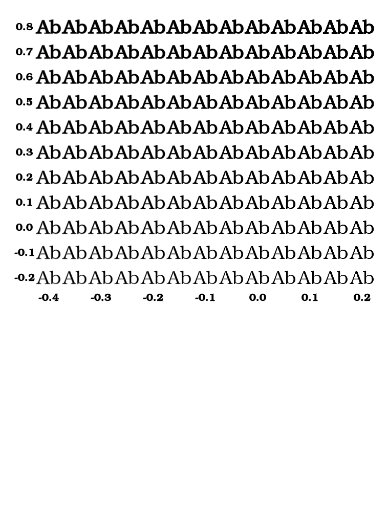

One more thing about TypeGenius. Let's say that you raised weight slider 2 steps, you can't turn the type back to the original weight and sharpness by lowering two steps. You have to edit Kobo's config file under .kobo/Kobo/Kobo eReader.conf (if you are using Linux or OS X dot before the file or folder name means the file or the folder is hidden, I have no idea if they are also hidden in Windows, never used it) and remove sharpness and weight lines for the font you want to reset.
And a recommendation, before playing with weight, you should check optical sizes and the book styles of your typeface if there are any. You also have to reboot the device after installing different forms of the same typeface. Caption usually works well with eInk with its lessened details and high x-height.

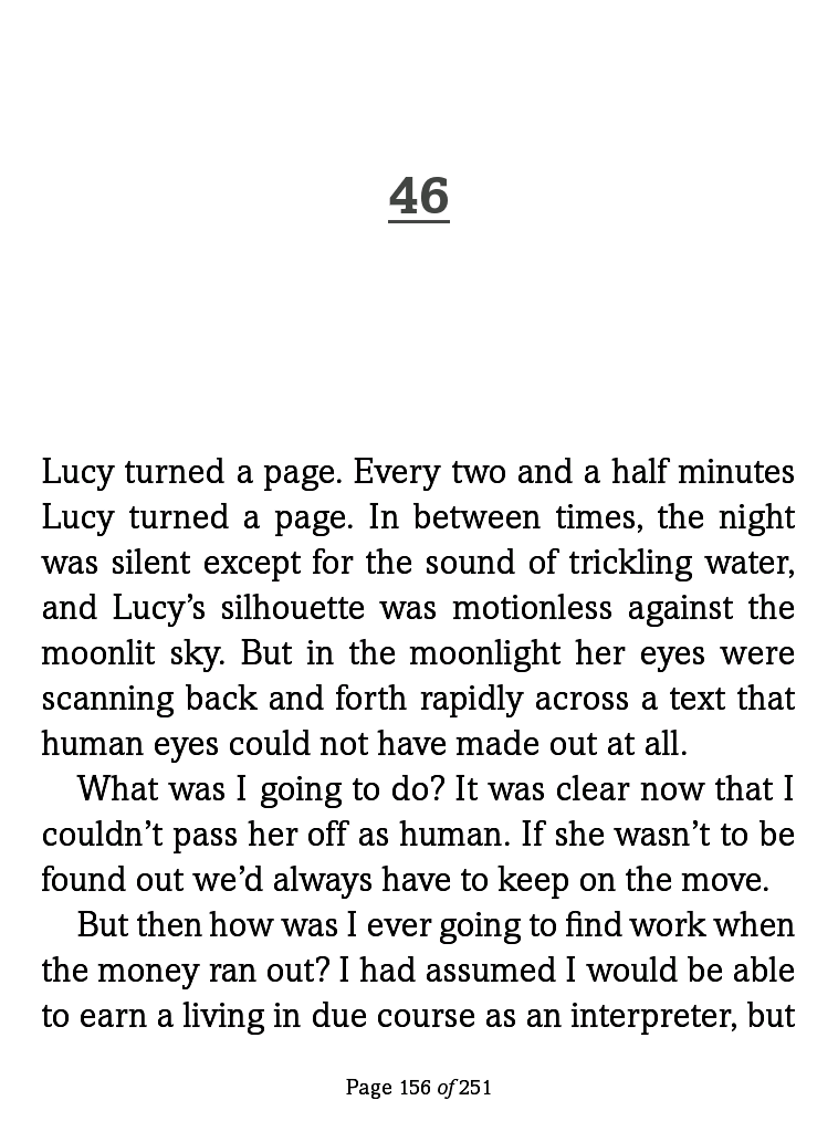

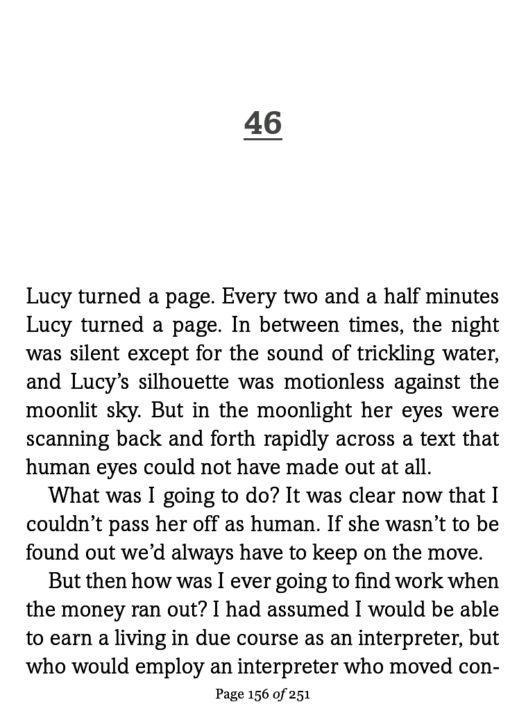

Custom reading footer style
The reading footer is the area at the bottom of the screen where the page number or other progress indicator is displayed. The `Custom reading footer style` patch allows the following properties of the footer to be changed:
  • Footer height (the amount of screen reserved for displaying the footer),
  • Font size used for the progress indicator,
  • Vertical position of the progress indicator within the footer.
(In some firmware versions it is also possible to change the font face used for the progress indicator, although that can sometimes be problematic.)
In general, the default values for the patch result in a footer of about half the height of the one in the unpatched firmware. The same footer is used for both the EPUB and KEPUB reader, but as the KEPUB reader has a large header matching the large original footer, the smaller patched footer will probably look too small when reading kepubs.
Note that other factors in the book's stylesheet can affect the size of the gap between the text and the progress indicator: line spacing, paragraph spacing, @page margins, widows/orphans settings, and others.
The screenshots attached (Glo, 3.15.0) show a sideloaded epub with the line spacing adjusted to get the text close to the footer in both cases:
1. Unpatched
2. Patched (default values for Glo)
ID:	138059   Click image for larger version

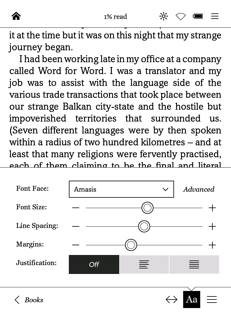

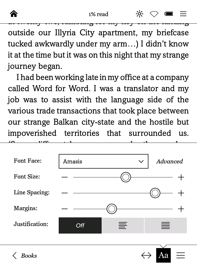

My 15 line spacing values

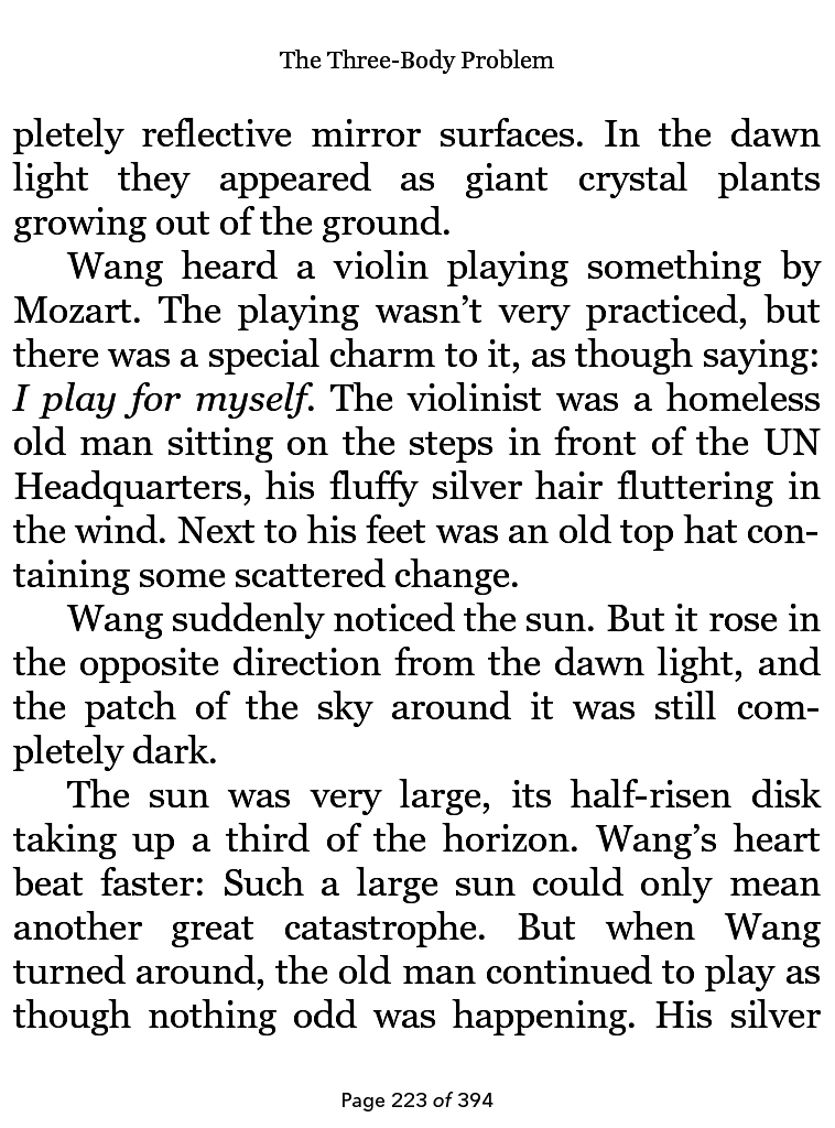

The unpatched firmware allows adjustment of the line spacing via a slider with 15 positions. However most people use only the lowest few settings, as the highest settings are far too wide to be useful. The `My 15 line spacing values` patch allows the 15 stock choices to be replaced with your own 15 custom values.
The final line spacing on the page depends on a number of factors, including choice of font face, publisher's settings in the book's stylesheet, and whether the EPUB or KEPUB reader is used (see the `ePub unitless line height` patch to fix a problem affecting line spacing in the EPUB reader's stylesheet.)
My understanding is that the line spacing value set by the slider is a scale factor by which the device multiplies the base line height. The scale factors used by the unpatched firmware range from 1.0 - 3.0. The default values in the patch change this range to 0.7 - 1.1, but you can choose any custom range you want.
The screenshots below (Glo, 3.15.0) show 5 out of the 15 line spacing settings with a sideloaded epub using the Amasis font. From left to right, line spacing values are: 0.7, 0.8, 0.9, 1.0 (unpatched minimum), 1.1:
ID:	138132Click image for larger version
ID:	138133Click image for larger version
ID:	138134Click image for larger version
ID:	138135Click image for larger version

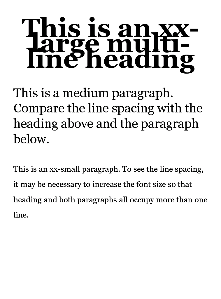

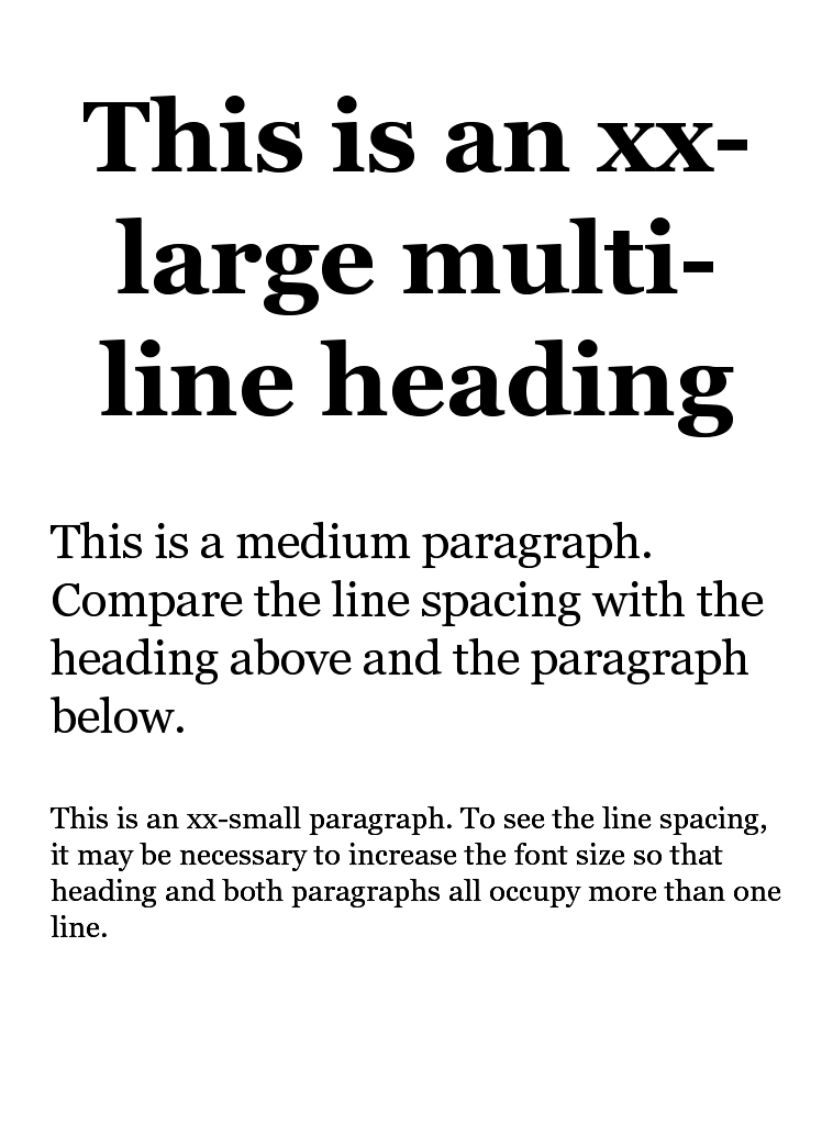

(This patch is available for firmware versions 2.8.1 - 3.15.0 but is no longer needed in current firmware as the problem described below was fixed in firmware version 3.16.0)
The Kobo firmware has separate built-in stylesheets for the EPUB and KEPUB readers where the default line height is set. There is a long-standing fault in the EPUB stylesheet which causes the line height to be set in proportion to the font size set from the font size slider, instead of in proportion to the final font size on the page as is done in the KEPUB reader. The `ePub unitless line height` patch fixes this fault.
(This problem might not be very noticable in books which don't use a wide range of font sizes, or where headings don't span multiple lines, or where the publisher forces a fixed line height instead of using the default set by the reader.)
The screenshots below (Glo, 3.2.0) show a page from a demonstration epub which has three different font sizes set in the book (xx-large, medium, xx-small), with the line spacing adjusted via the slider to suit the medium font size:
1. Unpatched,
2. Patched.

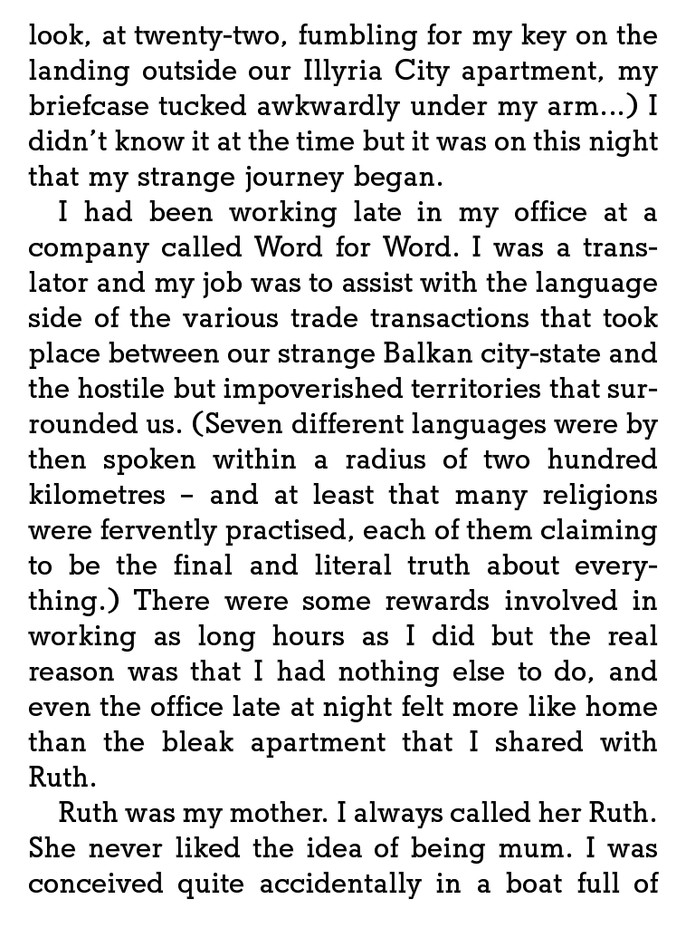

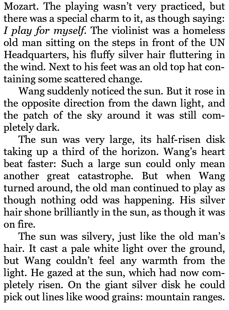

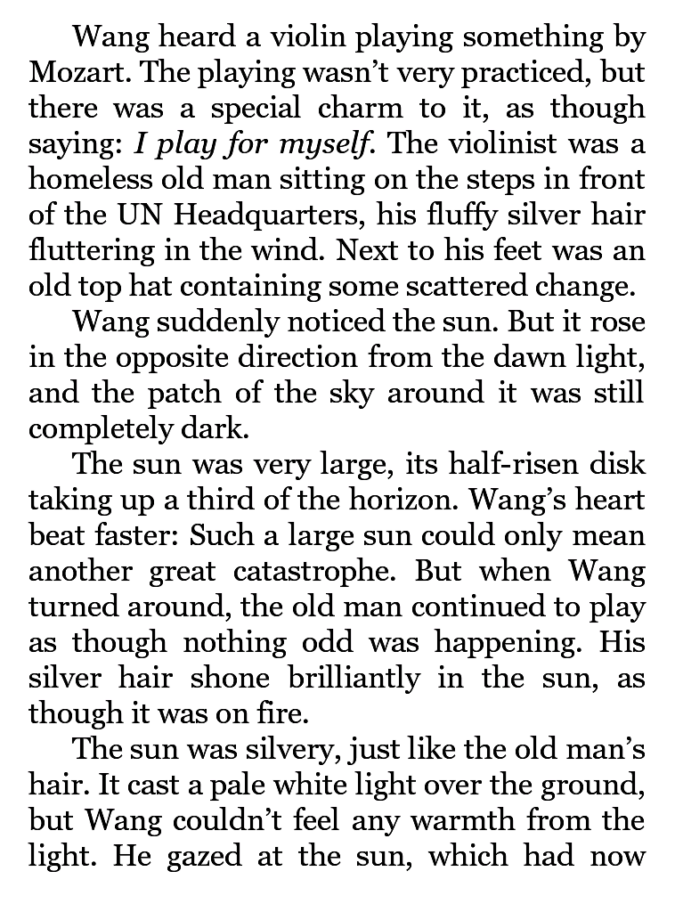

ID:	138453Click image for larger version
ID:	138454Click image for larger version
(Note that all screenshots are with the `Fix kepub side bearing font cut-off bug` patch applied, which makes the left/right margins an extra 0.2em larger.)

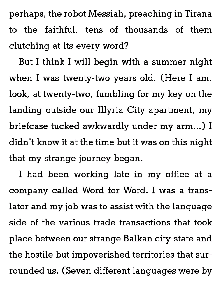

KePub/ePub fixed font sharpness
Glyphs are drawn on the screen using an anti-aliasing technique that can make curves and diagonal lines look smooth, avoiding the jagged look caused by the individual pixels. This is acheived by adding shaded pixels to the glyph to give the illusion of partial pixels, but this also reduces the perceived sharpness of the glyph. Therefore, for a given pixel size, increased sharpness is gained only by a reduction in smoothness, and vice versa.
The TypeGenius feature allows the weight and sharpness of each font to be adjusted. (See the `Freedom to advanced font controls` patch to enable TypeGenius for sideloaded fonts.) Adjustng the sharpness allows the ideal balance of smoothness vs sharpness to suit individual preferences.
The table in the following screenshots (Glo 3.15.0) shows the range of weight and sharpness values that can be set from the slider. This is only a sample of the possible values, the slider actually allows much finer adjustment. (These screenshots were created from this demonstration kepub using the built-in Georgia and sideloaded Tex Gyre Bonum fonts, and are best viewed at 100% zoom to see the increase in sharpness from left to right):
ID:	138858Click image for larger version
In firmware versions up to 3.1.1 the advanced fonts menu had separate sliders for weight and sharpness which allowed any combination of values to be selected. But from firmware version 3.2.0 there is only one slider which sets both weight and sharpness, so an increase in weight results in an increase in sharpness too. In effect this means only the combination of values along a diagonal from the lower left to upper right of the above table can be selected.
The `ePub fixed font sharpness` and `KePub fixed font sharpness` patches allow a fixed sharpness value to be chosen, e.g. 0.0, 0.1, or 0.2, so that the sharpness value selected by the adjustment slider is ignored and only the weight value used. In effect this means that the slider can be used to select combinations from a vertical column instead of from the diagonal of the table above.
It is also possible to set the weight and sharpness independently without patching by editing the device's configuration file and changing the values of readingFontWeight and readingFontSharpness in the [Reading] section. While these patches only allow one fixed sharpness value to be selected, they avoid the need to re-edit the configuaation file after adjusting the weight via the slider.

Enabling undocumented features
The kobo firmware has some undocumented or experimental features that are not active by default, but which can be enabled in the [FeatureSettings] section of the device's configuration file .kobo/Kobo/Kobo eReader.conf.
The configuration file is a plain ASCII file with unix line breaks. When editing it, it is important to use an editor that doesn't change the file type or line break style. Most Linux and Mac text editors should be okay, but don't use Notepad or Wordpad in Windows: use an editor such as Notepad++ instead.
(Enabling these features doesn't require patching at all, but some patches work in conjunction with undocumented features, so I've included this post here for reference.)
An example of an undocumented feature is FullScreenReading which, once enabled, adds the following option to the Reading settings menu:
To enable a feature, e.g. FullScreenReading, edit the configuration file and add the new feature to the [FeatureSettings] section. (If there is not already a [FeatureSettings] section, then add that too.) The result should look like:
[FeatureSettings]
FullScreenReading=true
Additions to [FeatureSettings] will remain in place after a firmware update. If you want to disable the feature you can edit the configuration file again and change its setting from true to false.
