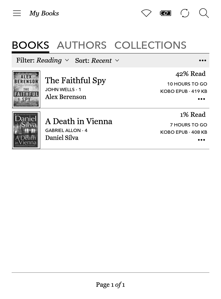

Increase The Books Cover Size In The Library
<Patch>
patch_name = `Increase The Cover Size In Library`
patch_enable = `no`
# Multi-version patch: 4.6.9660
## See https://www.mobileread.com/forums/showpost.php?p=3241532&postcount=82

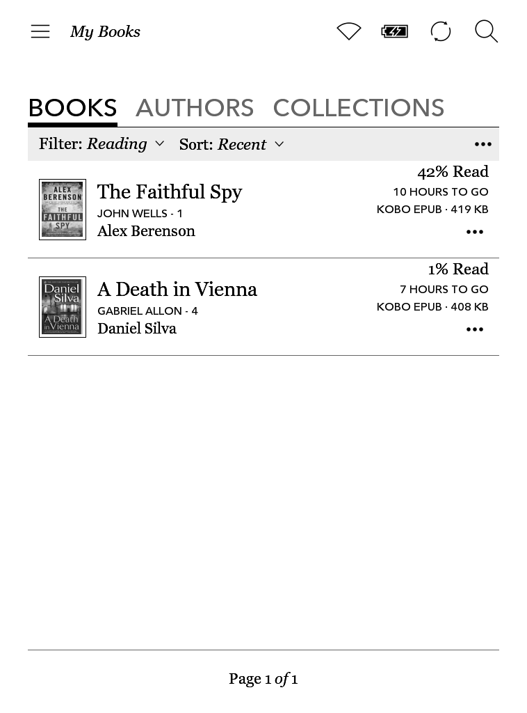

* Small change I add is increasing the padding to Read status in the right side.
ID:	159313Click image for larger version

Other patches:
nickel.patch
`Increase headlines font`
<Patch>
patch_name = `Increase headlines font`
patch_enable = `yes`
# Multi-version patch: 4.6.9660+
## See https://www.mobileread.com/forums/showpost.php?p=3520879&postcount=42
# Increas the font size in My books, Activity, Bookstore...
find_base_address = `\x9C\xB5\x95\xD1\x4F\xAB\x30\x18\xC5\xDF\xFD\x2B`
