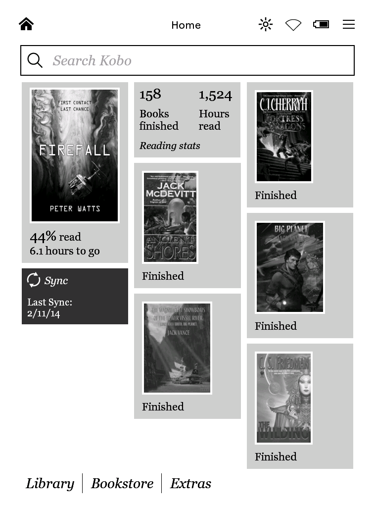

A patch to squeeze a third row of book tiles onto the Glo/Aura homescreen, see this screenshot for example. (libnickel.so.1.0.0.patch):
Glo:
<Patch>
patch_name = `Compact homepage layout (Glo)`
patch_enable = `yes`
#DragonHomePageView (Search bar height)
replace_string = D51AE8, `min-height:100px;`, `min-height:090px;`
replace_string = D51AFB, `max-height:100px;`, `max-height:090px;`
#QWidget (Space below search bar)
replace_string = D51C81, `min-height:40px;`, `min-height:08px;`
replace_string = D51C93, `max-height:40px;`, `max-height:08px;`
#MultiColumnTileView (Space between tiles)
replace_string = D51E31, `horizontalSpacing:10;`, `horizontalSpacing:04;`
replace_string = D51E52, `verticalSpacing:10;`, `verticalSpacing:04;`
#footer (Footer menu bar height)
replace_string = D5227E, `min-height:95px;`, `min-height:68px;`
replace_string = D52290, `max-height:95px;`, `max-height:68px;`
#PhoenixSmallRecentBookTile
replace_string = D59024, `percentFontSize:28;`, `percentFontSize:22;`
replace_string = D59043, `progressFontSize:22;`, `progressFontSize:22;`
#RecentBookTile
replace_string = D5C51B, `percentFontSize:28;`, `percentFontSize:22;`
replace_string = D5C540, `progressFontSize:22;`, `progressFontSize:22;`
</Patch>
Aura:
<Patch>
patch_name = `Compact homepage layout (Aura)`
replace_string = D51C81, `min-height:40px;`, `min-height:02px;`
replace_string = D51C93, `max-height:40px;`, `max-height:02px;`
replace_string = D51E31, `horizontalSpacing:10;`, `horizontalSpacing:02;`
replace_string = D51E52, `verticalSpacing:10;`, `verticalSpacing:02;`
#RecentBookTile
</Patch>
