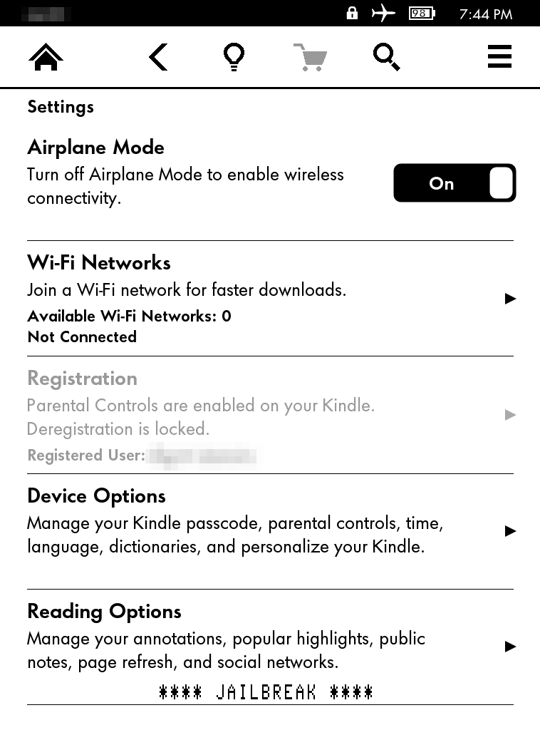

INSTALL:
Jailbreak:
Download the K5 JailBreak package from the Snapshots thread, and unpack it. In here, you'll find a few files.
Unzip the contents of the kindle-5.4-jailbreak.zip archive to the root directory of your Kindle.
Now, eject & unplug your Kindle, and go to [HOME] -> [MENU] > Settings -> [MENU] > Update Your Kindle. The updater won't actually ever run, this is normal. After a few seconds, the words **** JAILBREAK **** will appear at the bottom of your screen to confirm that the device is jailbroken . You won't see this message again, it's simply a confirmation message.
And that's it, your Kindle is now ready to install custom hacks!
Since v1.11.N: If you need to use something MKK-powered immediately, be aware that MKK will only be active on the next boot. Installing another package through the Update mechanism will do the trick, or you can manually trigger a device restart ([HOME] -> [MENU] > Settings -> [MENU] > Restart).
