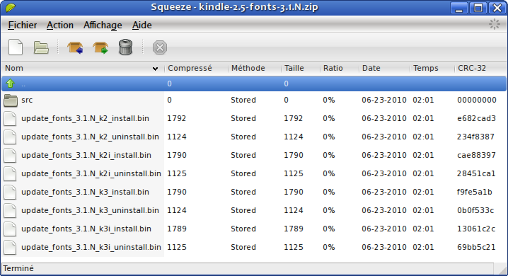

Download the attached kindle-jailbreak-0.13.N.zip file, and unpack it. In here, you'll find a few files.
Leave the directory alone, and upload the correct Update_*_install.bin file for your kindle & FW version to the root directory of your Kindle.
(As always, k2 means K2 US, k2i means K2 GW, dx means KDX US, dxi means KDX GW, dxg means KDX Graphite, k3g means K3 3G (US [B006]), k3w means K3 WiFi [B008], k3gb means K3 3G (UK [B00A]) and k4 means K4 [B00E]. The ones suffixed by -3.0-to-3.2 are meant for devices running old FW <= 3.2 *only*!).
For a Kindle 3 WiFi running firmware 3.3.x or 3.4.x, that would be Update_jailbreak_0.13.N_k3w_install.bin for example.
Now, eject & unplug your Kindle, and go to [HOME] -> [MENU] > Settings -> [MENU] > Update Your Kindle. It should be quick. (And, on FW 2.x only, it should FAIL (With a U006 error, in the bottom left corner of the screen). It's completely normal, intended, and harmless).
And that's it, your Kindle is now ready to install custom hacks!

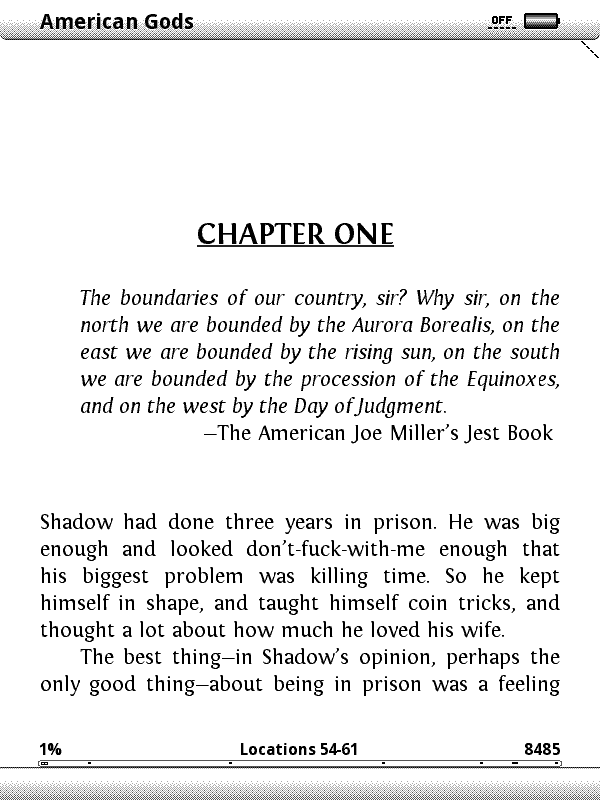

Fonts:
What Does It Do?:
This will allow you to customize the fonts used by your Kindle, be it in books, or the UI, and optionally grant you deeper control over the font rendering engine.

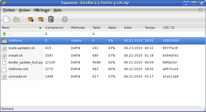

Download the appropriate kindle-fonts-5.16.N.zip file for your device (the K2, K2I, DX, DXI and DXG packages are in the kindle-fonts-5.16.N-k2.zip archive, the K3G, K3W and K3GB packages are in the kindle-fonts-5.16.N-k3.zip archive, and the K4 packages are in the kindle-fonts-5.16.N-k4.zip archive), and unpack it. In here, you'll find a few files.
First, upload the correct Update_*_install.bin file for your kindle to the root directory of your Kindle.
For a Kindle 2 International, that would be Update_fonts_5.16.N_k2i_install.bin for example.
Now, eject & unplug your Kindle, and go to [HOME] -> [MENU] > Settings -> [MENU] > Update Your Kindle. It should take a few dozen of seconds. If you're on FW 3.x or 4.x, and this is your first install, it may seem to hang for about a minute or two on the "Update successful, Your Kindle is restarting…" screen, that's okay.
Note that if you have KUAL set up and running, you're welcome to use our very own MR Package Installer, which may speed up the process if you're installing multiple things .
If you want to change the fonts used by the hack, you'll have to upload them in the linkfonts/fonts directory, strictly following the usual naming scheme. (Type_Style.ttf) (for details on where each font is used, please see this post). The default fonts installed by the hack are the usual non-cjk unicode fonts (Droid Sans, Droid Serif & DejaVu Sans Mono), with the addition of the CJK-aware Droid Fallback if you're on FW 3.x or 4.x. You'll find a bunch of other prepackaged, ready to use, font sets here, and in the next few replies.
You'll have to restart your Kindle in order to properly take your new fonts into account.
By default, the autoreboot feature is enabled. If you wish to make use of it, don't forget to drop a blank file named reboot in the linkfonts folder (right alongside the "autoreboot" file, by copying and renaming it, for example). When that file is present, your Kindle should automatically do a quick reboot 10s after you've unplugged it.

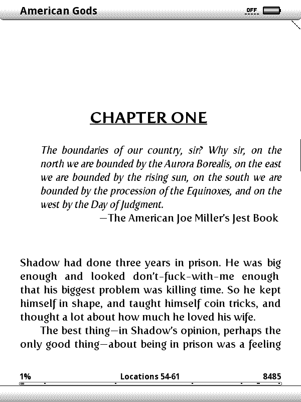

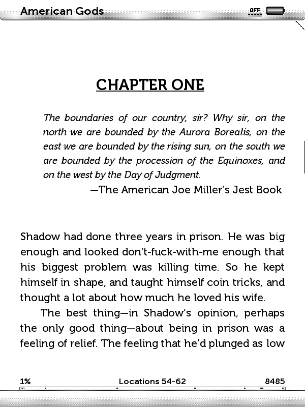

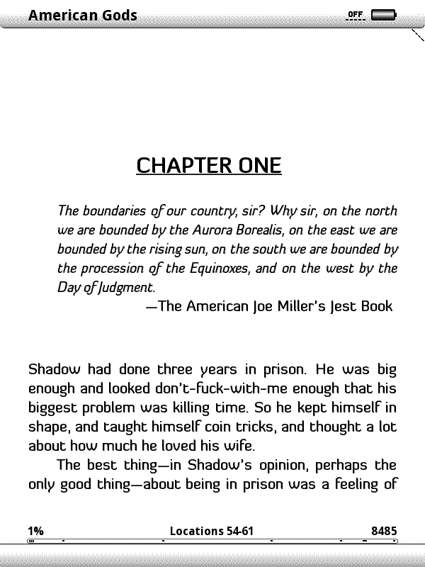

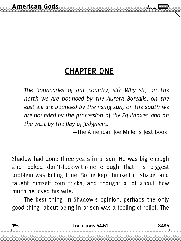

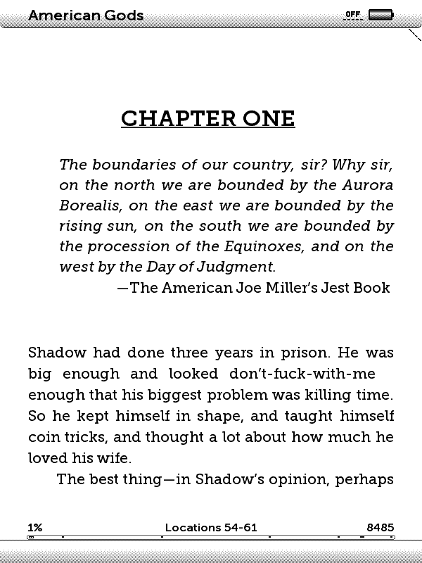

And here are the usual screenshots of the result of the default font hack
And a few of the fonts sets posted in the next post adapated to the K3 (basically, we use the OpenType CFF font instead of a crappy TTF conversion when we can, and when the CFF looks good). Also, please check this post for those same files packaged as an update file, to avoid potential weird issues on FW 3.x.
UPDATE: To err on the side of caution regarding MR's rules on attachments, a bunch of those sets have been pulled. If you'd like to use these fonts, you'll have to get them from somewhere else, or extract them from packages from other hacks.
Tedsan's packages (Georgia, Helvetica, CMod*, ArialRndNrw)

And what a broken font might look like... (Calibri bold I think, from an up to date Win7). With the otherwise pretty nice Candara font on the Serif side of things.
And some font sets with fonts from the exljbris font foundry (solely based on the freely available styles).
ID:	53921   Click image for larger version
ID:	54589   Click image for larger version
ID:	54590   Click image for larger version
ID:	54591   Click image for larger version
ID:	54592   Click image for larger version
ID:	54610   Click image for larger version

Download the attached kindle-2.5-fonts-3.1.N.zip file, and unpack it. In here, you'll find a bunch of .bin files, and a src directory.
This time, we'll need the linkfonts directory inside the src directory. Upload it to the root of your Kindle. (You should then have a linkfonts directory alongside your documents folder).
QUESTION: I unpacked the winzip file, I didn't see anything indicating src? If I do find this are you saying to create the src directory first and then place linkfonts inside this directory? Also, inside the Winzip package, I see two linkfonts (1) linkfonts and (2) linkfonts-init. Which one should I use.
THanks so much to everyone that help bring the fonts back, I miss my Georgia 2 desparately!
chilady1 is offline   Reply With Quote
Old 06-22-2010, 10:51 PM   #12
NiLuJe
BLAM!
NiLuJe's Avatar
Posts: 13,507
Karma: 26047434
Location: Paris, France
When you unpack the .zip file, you should end up with a new folder named 'kindle-2.5-fonts-3.1.N'.
Inside this folder are the bunch of .bin files, and a folder named 'src'.
And now, inside this 'src' folder is our 'linkfonts' folder, and it's this last one you'll have to copy to the root of your Kindle. There's no folder to manually create anywhere .
Check my two crappy snapshots.
ID:	53924   Click image for larger version
It helps to FOLLOW THE INSTRUCTIONS to the letter as in UNPACK the winzip file. Having done that now, I see the src folder. Thank NiLuJe. My dumbness. Your instructions were clear.
