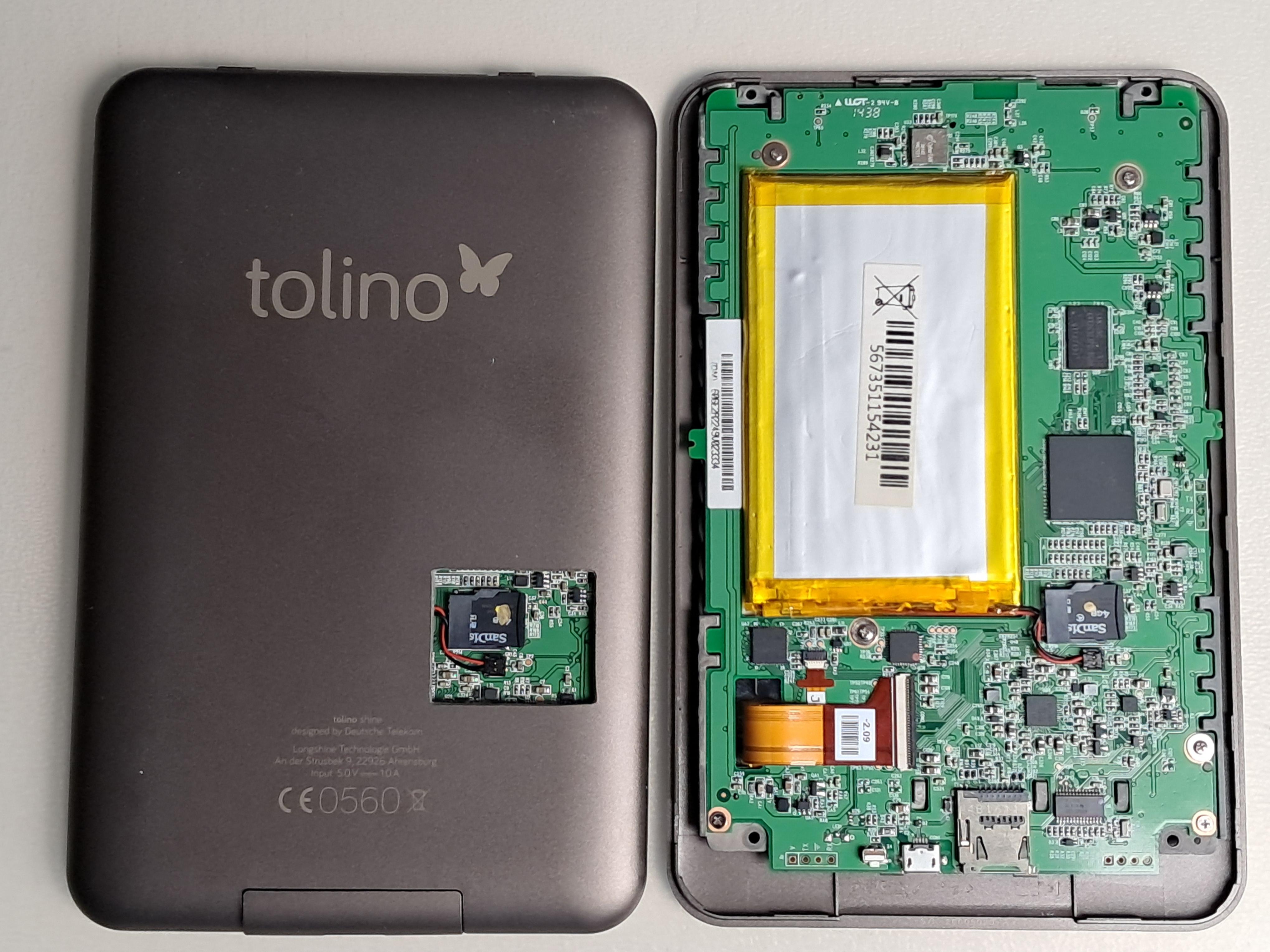

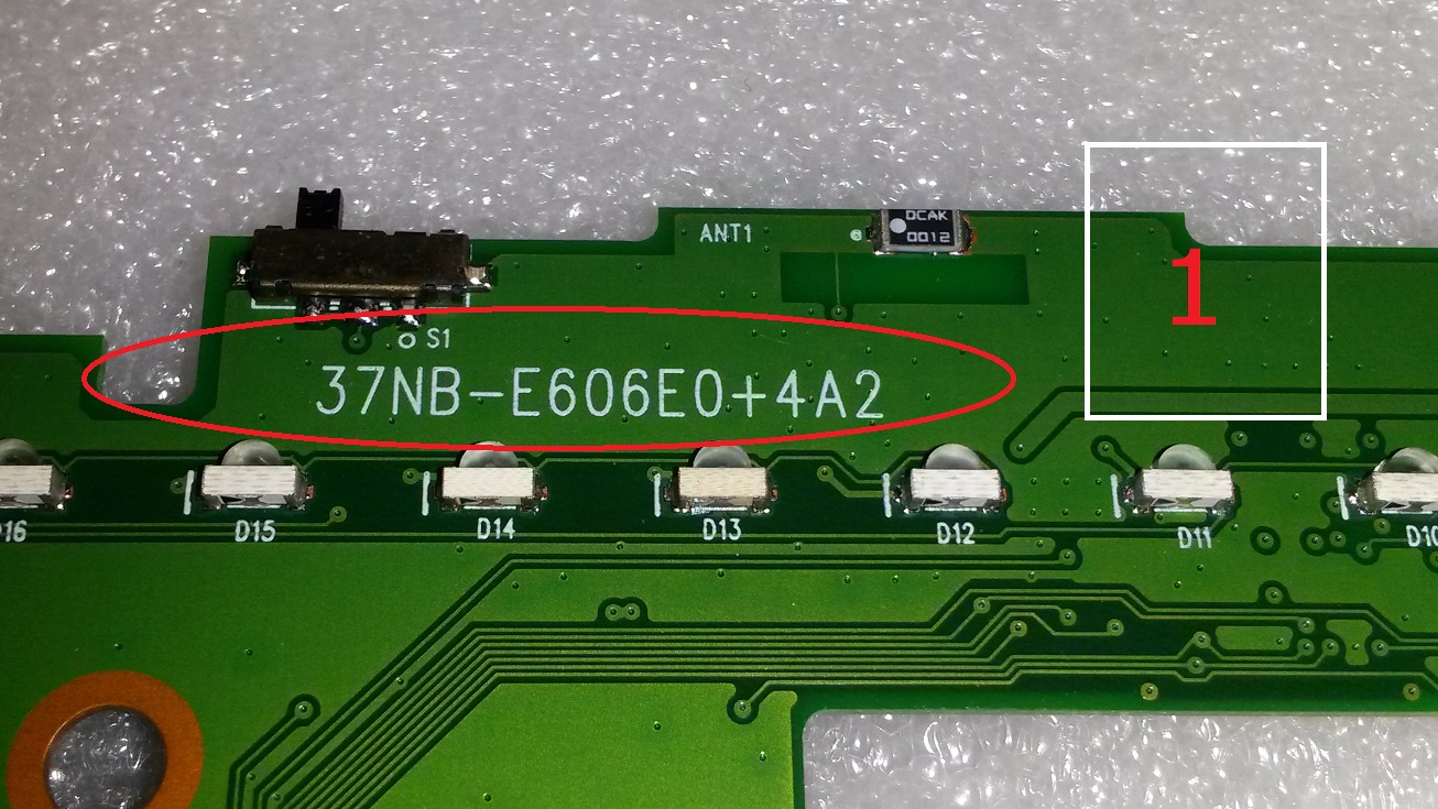

What are the first two digits of the serial number? 20, 21, or 22?
If it's 20 or 21 (4A2 motherboard), you can install an internal microSD card with a Kobo Glo image. Trust me, this is a better option with KOReader than searching for an older version for Android 2.3.4.
In any case, you need to disassemble the device.
@Waldy, it is a 20. So i will look for one of those roms. Does it have a special version or modelname? just any Kobo Glo image, saw some posts about Kobo Glo (Model N613) and Kobo Glo HD?

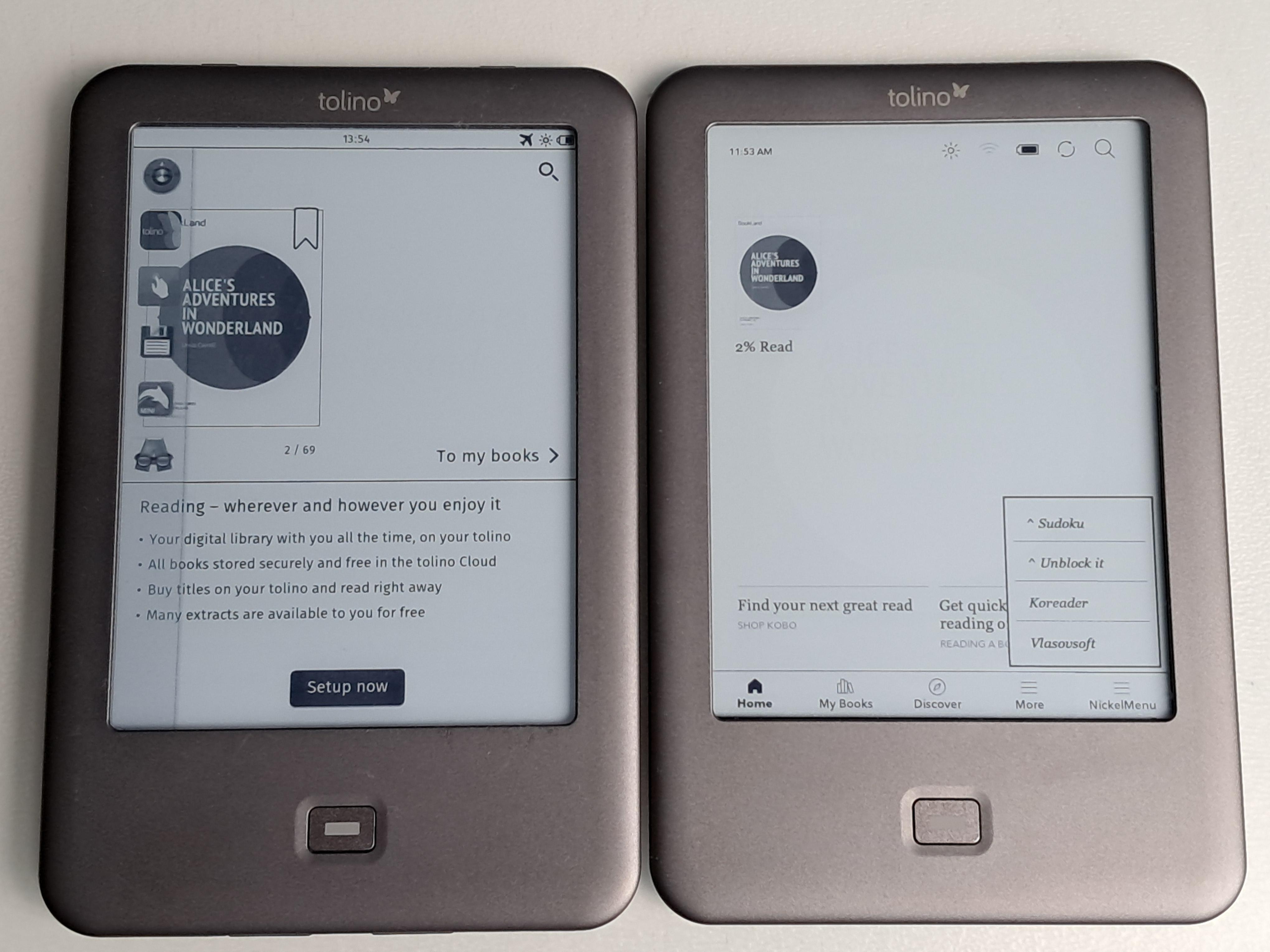

greetings d
N613
I sent you an image. The home button now toggles the backlight on/off. Unfortunately, the backlight adjustment between 50% and 51% has a large step.
