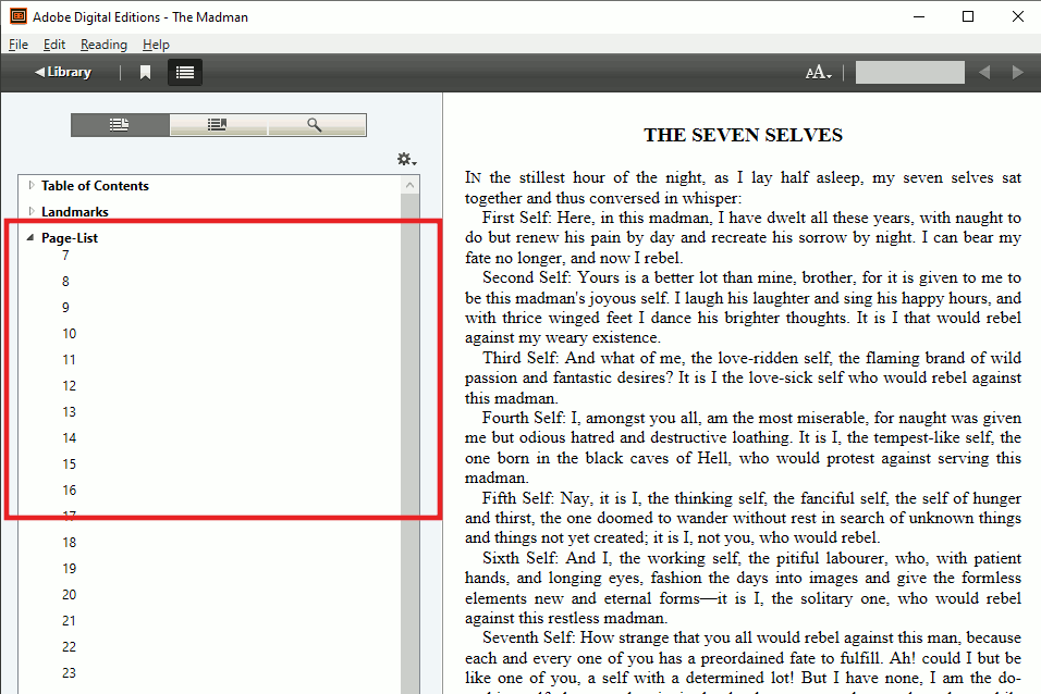

If you design the files properly, the RPNs will show up. In ADE, the pages are listed below the TOC. (See image I posted last year.)
