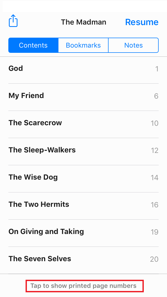

iBooks/Apple Books supports printed page numbers, but only in epub3 books. (You can convert your epub2 book to an epub3 book with the ePub3-itizer Sigil plugin.)
Note that in iBooks/Apple Books, you'll need to select the TOC and then tap Tap to show printed page numbers. (If you don't see this option, the NAV page list is invalid or missing.)
