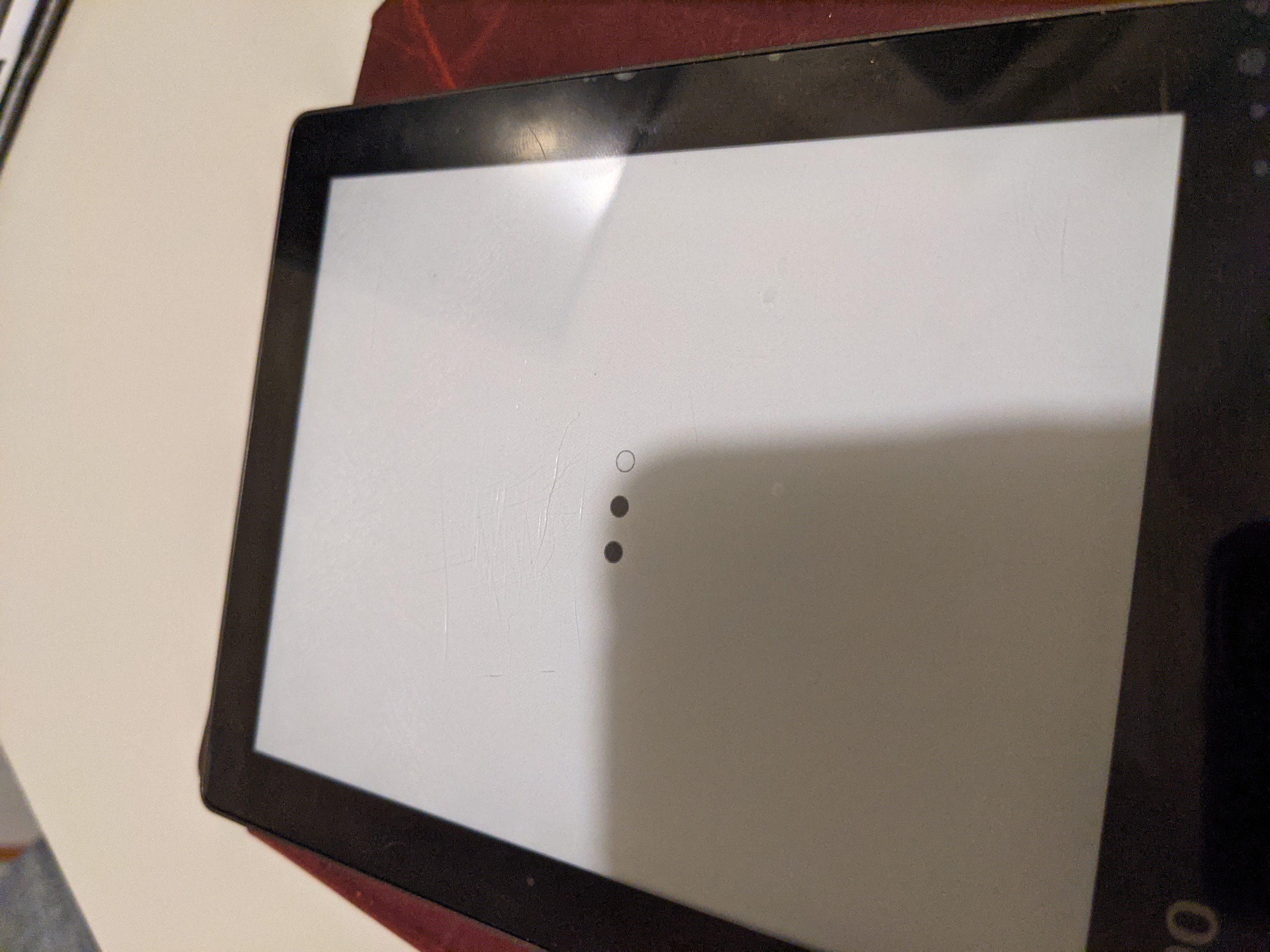

Hi all. I'm hoping you can help me out. I recently bought an used Kobo Aura. Was unable to check if it's working as the battery was down. First issue was inability to connect to my home broadband. After entering the password it freezes. Thought I will connect to my PC and install kobo app. The registration went well but it still keeps freezing and wouldn't start. It only shows three dots like it's processing something and only if it's connected. Once disconnected it freezes again. I suspect it's a software issue but no clue how to fix it. Any ideas? Thx.

No idea if the Aura has eMMC or MicroSD but an image might help.

Just tried that and after restarting the three dots reappear. I made up to 10 attempts I believe. It looks like someone have totally formatted it and removed OS.
Forgot to mention the orange light flashes and the "reading" dots appear when kobo is connected to a PC or plugged to a charger. Once disconnected is freezes.

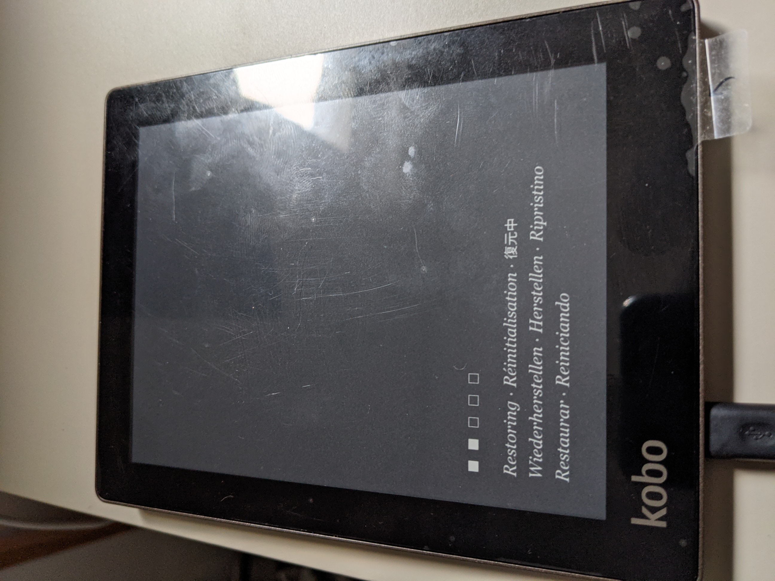

Step 2 caused the e-reader to freeze. I did step 3 and 4 and while restarting it got frozen again. When I unplug and plug it again it restarts and three dots appear and you can start over.
That definitely points to battery problems. With that, I would try steps 3 and 4 immediately after plugging it in. The Kobo devices will normally wake or start up a short period of time after plugging them in. If you wait to long, you will need to do the power off.

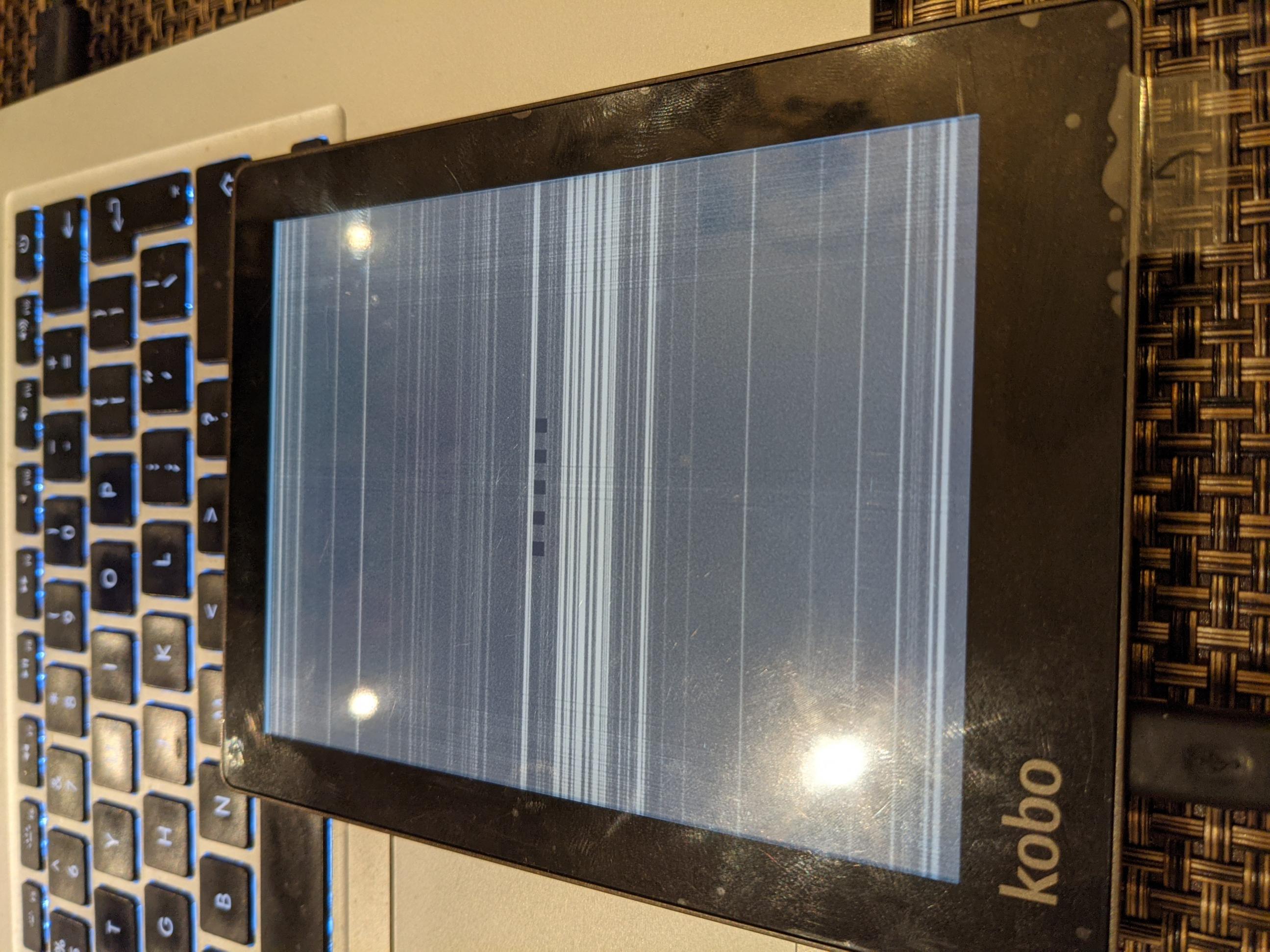

Thanks. So I inserted an SD card with an image. It looked promising at first but it froze after few seconds and looks like on the attached pic. It looks like the screen is a problem and not the battery (unless both).
