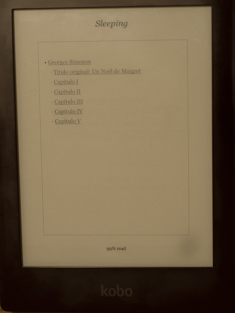

I just assumed it ran out of battery because that's what usually happens to me.
The screen wasn't broken, but I can't rule that out because I have a little girl a bit too adept at throwing things.
The LED goes the usual white.
On the screen it shows 'Sleeping', the cover of the last book I read, and '99% read'.

The screen looks fine, but there is a slight bruise on the bottom right corner that I hadn't noticed, so that might be it.
It doesn't look very difficult to replace, and it can be bought from China, but for 85€ which is expensive considering I'm not sure the screen is the (only) problem.
Thanks for your help, I'll try to change the threat title to reflect reality.

I think the screen does not look broken. Maybe people with more experience can tell better.

Your image is too big, max is 600x600 for images imbedded in the post. The Aura HD doesn't have colored lights, it does blink faster when starting the factory reset.

E-Ink "bruise" looking similar to yours can be caused by magnets but it's not permanent damage, goes away with refresh.
It's odd to not have the display at least refresh on poweron/reset; by all means try replacing the SD card.
As for photos you shot yourself, you should just Attach them to your post.
