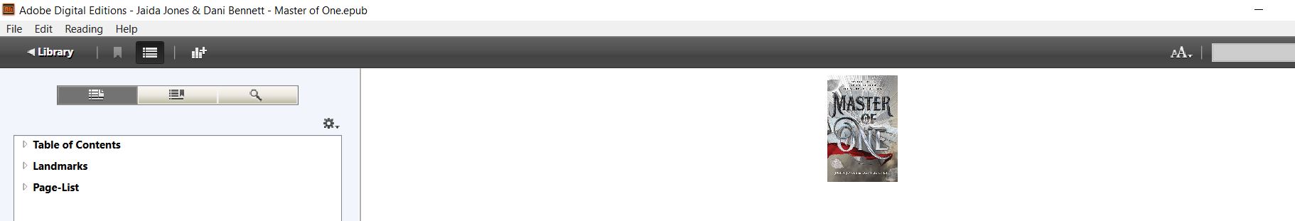

Hello,
I normally use the Polish feature in calibre to update the cover image in the ebook. This has worked rather well in the past.
Today when I used "Polish" "update the cover in book file" the cover image doesn't appear correctly in Adobe Digital Editions 4.5.8.
Here is the code from the Calibre "Edit Book" for the cover image prior to using "Polish."
<body epub:type="frontmatter">
<div class="cover" id="cover">
<img alt="image" src="../images/9780062941473_Cover.jpg"/>
</div>
</body>
This is the code after using "Polish" update cover image.
 <body>
        <div>
<svg version="1.1" xmlns="http://www.w3.org/2000/svg"
xmlns:xlink="http://www.w3.org/1999/xlink"
width="100%" height="100%"
viewBox="0 0 1350 2040" preserveAspectRatio="none">
<image width="1350" height="2040" xlink:href="../images/cover.jpg"/>
            </svg>
        </div>
    </body>
I've attached a screenshot of what this cover looks like in Adobe Digital Editions. The cover looked fine in "Edit Book" and in the Calibre "Viewer" so I'm not sure what went wrong with Digital Editions.
I'd appreciate any and all help in solving this mystery.
Best Regards,
Amalthia

As a start, I'd suggest changing the preserveAspectRatio="none" to preserveAspectRatio="xMidYMid meet"

Hi,
I changed the preserveAspectRatio="none" to preserveAspectRatio="xMidYMid meet" and well the cover looks like a cover but it's a tiny icon cover, in sea of white blank space. I've attached a screenshot.
preserveAspectRatio="none" is the default for "Polish Book" update cover.

It appears the novel I was viewing in Adobe Digital Editions (ADE) was a epub 3 file. I converted the novel to epub 2 and the cover art is back to it's normal size.
Thanks to everyone who tried to help solve this mystery.
