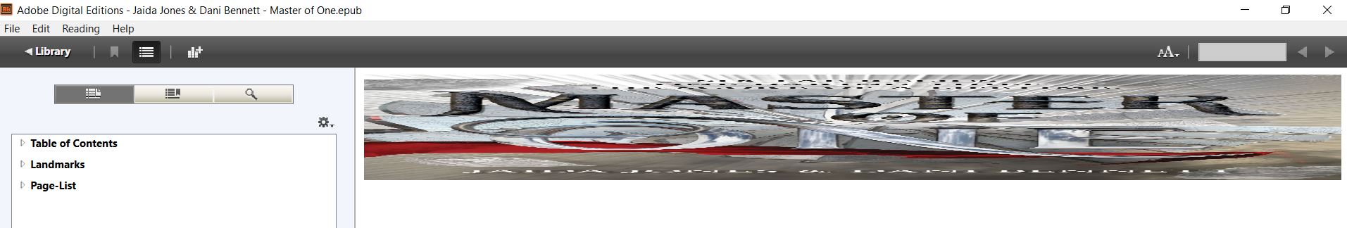

Hello,
I normally use the Polish feature in calibre to update the cover image in the ebook. This has worked rather well in the past.
Today when I used "Polish" "update the cover in book file" the cover image doesn't appear correctly in Adobe Digital Editions 4.5.8.

I've attached a screenshot of what this cover looks like in Adobe Digital Editions. The cover looked fine in "Edit Book" and in the Calibre "Viewer" so I'm not sure what went wrong with Digital Editions.
I'd appreciate any and all help in solving this mystery.

As a start, I'd suggest changing the preserveAspectRatio="none" to preserveAspectRatio="xMidYMid meet"

I changed the preserveAspectRatio="none" to preserveAspectRatio="xMidYMid meet" and well the cover looks like a cover but it's a tiny icon cover, in sea of white blank space. I've attached a screenshot.
preserveAspectRatio="none" is the default for "Polish Book" update cover.

kovidgoyal solved the problem I was having in another MobileRead post: https://www.mobileread.com/forums/sh...36&postcount=8
It appears the novel I was viewing in Adobe Digital Editions (ADE) was a epub 3 file. I converted the novel to epub 2 and the cover art is back to it's normal size.
Thanks to everyone who tried to help solve this mystery.
