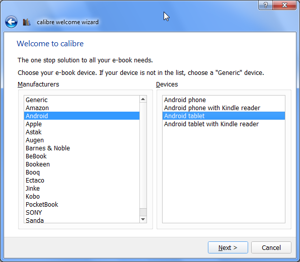

I just re-ran the Calibre Welcome Wizard to see if it would confirm my device selection. It does, and it is the Nexus, not the Kindle. I know it was originally the Kindle, but I changed it when I got the Nexus. I use both now, but mainly the Nexus and with CC. The Kindle gets sync'd rarely and if so, by USB.
NSILMike is offline   Reply With Quote

Originally Posted by NSILMike View Post
Mike-> CNET News
Hmmm, this is confusing. As far as I can tell, the only way that the date is not in the title (I see CNET News [Mon, 27 Jul 2015]) is for the output profile to be a kindle. Perhaps there are some defaults lying around that I haven't found. Also, I cannot find any way to set the output profile to "Nexus". The closest I can find is "Android tablet". Where did you see "Nexus"?

In any event, and assuming you use news scheduling and not the command line, and assuming that the output profile is something like "Android tablet", the next time you fetch news the title of CNET should have the date in it. That will fix the overwrite and date change problems.
Old 07-27-2015, 01:31 PM   #40
Attachment 140589
1) Nothing on my tablet or in Calibre has a date in the title. The date is visible in both in separate fields, but not in the title.
2) Yes, I said Nexus to be as specific as I could.
As far as I can tell the first can happen only if the output profile is for a kindle. Also, and again as far as I can tell, there must be a configuration file containing the output profile. Something isn't right in River City. Note: if something changed the output profile then only newly-downloaded news will have the date in the title.
Could you at some point check the configuration file again? To get there, go to Preferences, Miscellaneous and tap "Open calibre configuration directory". A folder browser should open. Navigate to the "conversion" folder. You will see a lot of files where one of them must be "page_setup.py". It should contain something very close to the following:
	'margin_left' : 5.0,
	'margin_top' : 5.0,
	'input_profile' : 'default',
	'output_profile' : 'generic_eink',
	'margin_right' : 5.0,
	'margin_bottom' : 5.0,
Thanks.

That file contains:
'output_profile' : 'kindle_fire',
'margin_top' : 5.0,
So, for some reason kindle is still there... How do I correct that?
Edit- I've changed it to Android Tablet.
That file contains:
'margin_top' : 5.0,
What worked for me was to start calibre normally, click the down-arrow on Preferences, and choose Run welcome wizard. You must select the correct profile on the second screen. On the third screen be sure to press the "Finish" button. The wizard should go away and calibre should restart. At this point the file should be changed.
Wow! The whole user experience on my tablet using CC improved dramatically! I had no idea what I was missing. The CC experience got close to, if not identical to the Calibre experience on a PC. Now I see the 'book' covers, and the ToC is vastly improved (and pretty similar to the Calibre version.) Also, the dates now show up in the book title as you had indicated was normal for a non-kindle device.
I'm sure this occurred because my initial device (which I still use semi-frequently) was a Kindle Keyboard. I had no idea to re-run setup when I got the Nexus android tablet, since it worked just fine.
Edit- Date shows up for all daily downloads except the New York Times. I have no idea why, but unless it indicates some other more serious issue, I also don't care.
For some reason the NYT recipe sets the time format specifier used to generate dates to '', effectively ensuring that there aren't any dates generated. I have no idea why whoever built the recipe did that. I also don't know what would happen if you customized the recipe and removed that specification. If I get some time I will try it.
