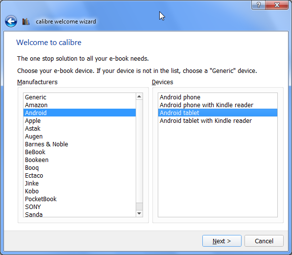

I just re-ran the Calibre Welcome Wizard to see if it would confirm my device selection. It does, and it is the Nexus, not the Kindle. I know it was originally the Kindle, but I changed it when I got the Nexus. I use both now, but mainly the Nexus and with CC. The Kindle gets sync'd rarely and if so, by USB.

Hmmm, this is confusing. As far as I can tell, the only way that the date is not in the title (I see CNET News [Mon, 27 Jul 2015]) is for the output profile to be a kindle. Perhaps there are some defaults lying around that I haven't found. Also, I cannot find any way to set the output profile to "Nexus". The closest I can find is "Android tablet". Where did you see "Nexus"?
Attachment 140589
In any event, and assuming you use news scheduling and not the command line, and assuming that the output profile is something like "Android tablet", the next time you fetch news the title of CNET should have the date in it. That will fix the overwrite and date change problems.
1) Nothing on my tablet or in Calibre has a date in the title. The date is visible in both in separate fields, but not in the title.
