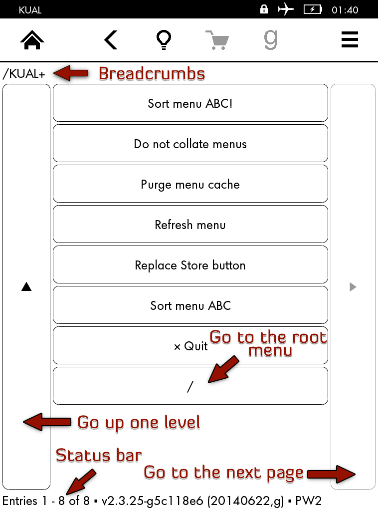

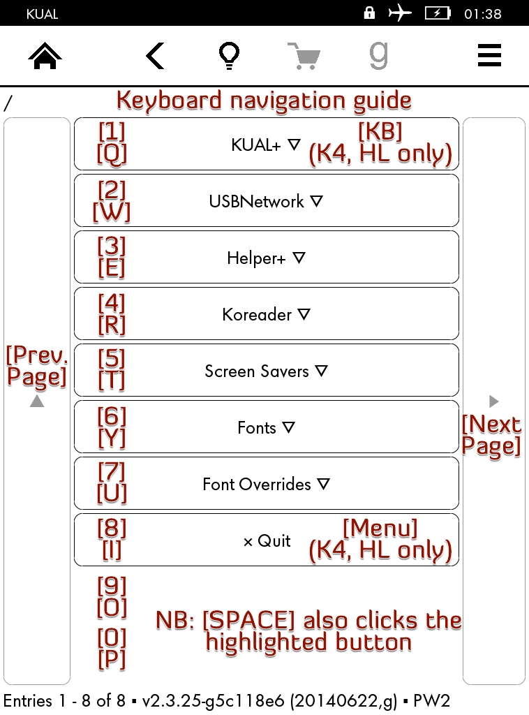

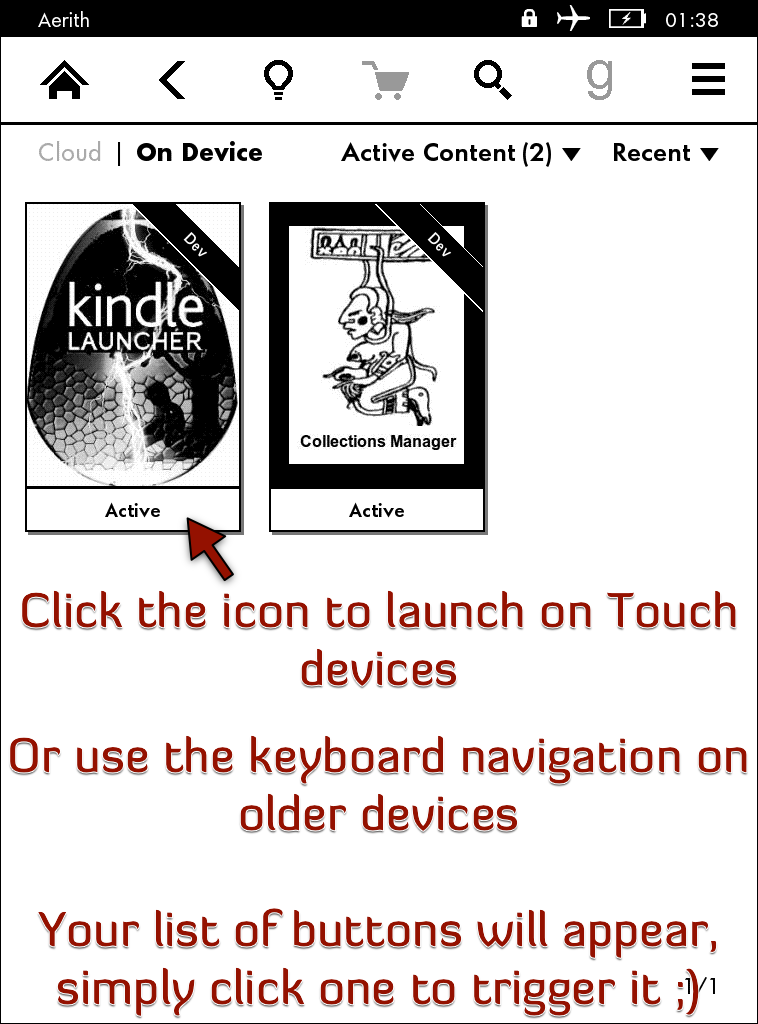

And that's it for the basics! You should now have a pretty KUAL button/entry on your Library (on recent FW, make sure you switch to the local Library view. In the same vein, on FW using a dedicated Homescreen page, you will never see KUAL in it). Right now, it won't be terribly useful, since KUAL ships without any extension, but now you have the tools to change that .
Check the screenshots attached to this post for a quick tutorial on how to actually navigate KUAL's UI .

Put KUAL-KDK-1.0.azw2 in documents folder.
Run it by clicking new kindlet document in your list.
(Touch, PW, PW2, KV, KT2, PW3)
Put KUAL-KDK-2.0.azw2 in documents folder.
Run it by clicking icon.
Expected output:
It should read through the /mnt/us/extensions folder and build a list of your extensions. Each command will create one button. you then click a button to launch the required application. Results are now paginated, and roll-around for easier scrolling.

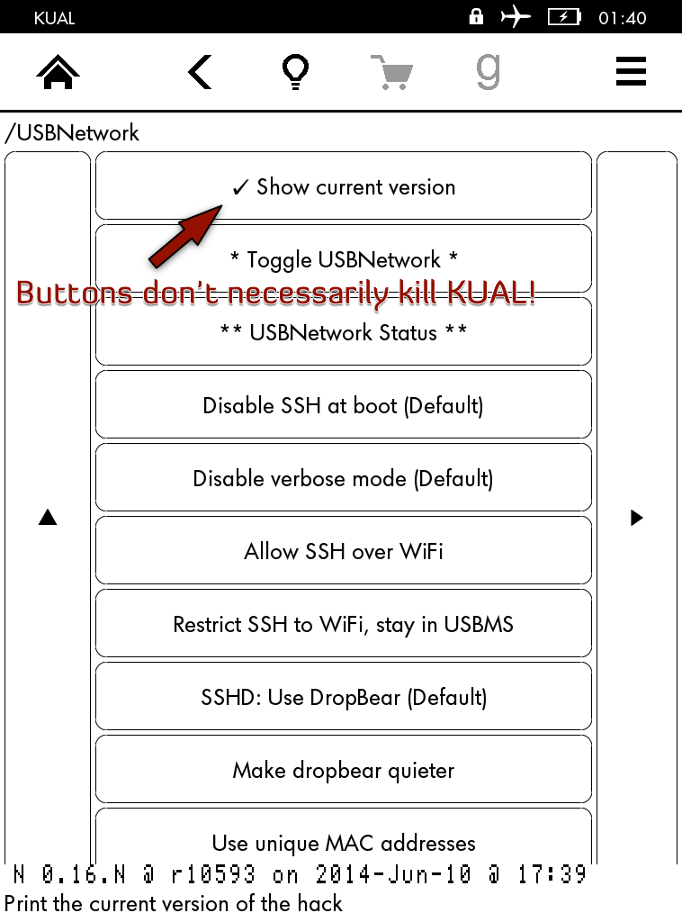

The "Helper" Extensions Optional extra
(All Devices) If you would like some helpful additional buttons you can get the Helper extension package from the Snapshots thread.
Unzip the archive and place the contents in the FAT ROOT. You of course don't need to put the ChangeLog & VERSION file on your device .
The USBNETWORK Extensions only work when usbnetworking app is installed.
The 711 Network report is Touch / PW specific at this time. Silently failing on other devices

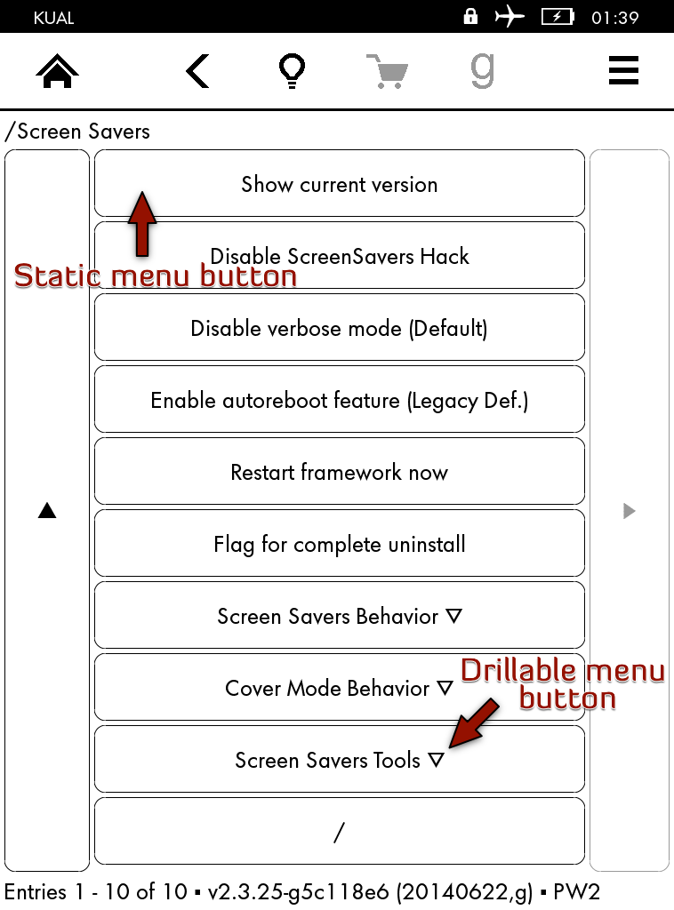

If you have a menu item you don't want. simply renaming the correct /mnt/us/extensions/<application name>/config.xml and menu.json to config-skip.xml and menu-skip.json will remove them from the lists next load. or delete the offending folders. your call.
Adding things to the menu
Simply construct a pair of config.xml and menu.json in it's own application subfolder under /mnt/us/extensions/<application name>/ just like before. The launcher should now parse it.
At a minimum point the menu.json to run at least one thing (like say a shell script) to be actually useful.

Currently we don't auto-parse the launchpad folder. So this process is required to support applications on the older (pre Touch) devices.
How Do I Exit?
The kindlet will generally exit when you click a choice
Currently just press the HOME key if you have one or the < icon.
Or select an item, the menu is generally self-terminating.
There is an option to make kual non-suicide on a per application basis, configurable in the startup configs. The "USBNetworking suite" demonstrates this in action.
I Have a Keyboard Device... Any Shortcuts?
Key-bindings have been added for devices with keys; PAGE forward and back now do what you expect and the top row (say q, w, e, r, etc.) will SELECT "options" (i.e KUAL BUTTONS) 1, 2, 3, 4, etc. Which is nice.
So what can you do with this?
Run other applications
For info on supported Known packages visit [KUAL] Extension Support and Versioning
An incomplete list follows, please DO visit the above link for the latest possible extensions:
