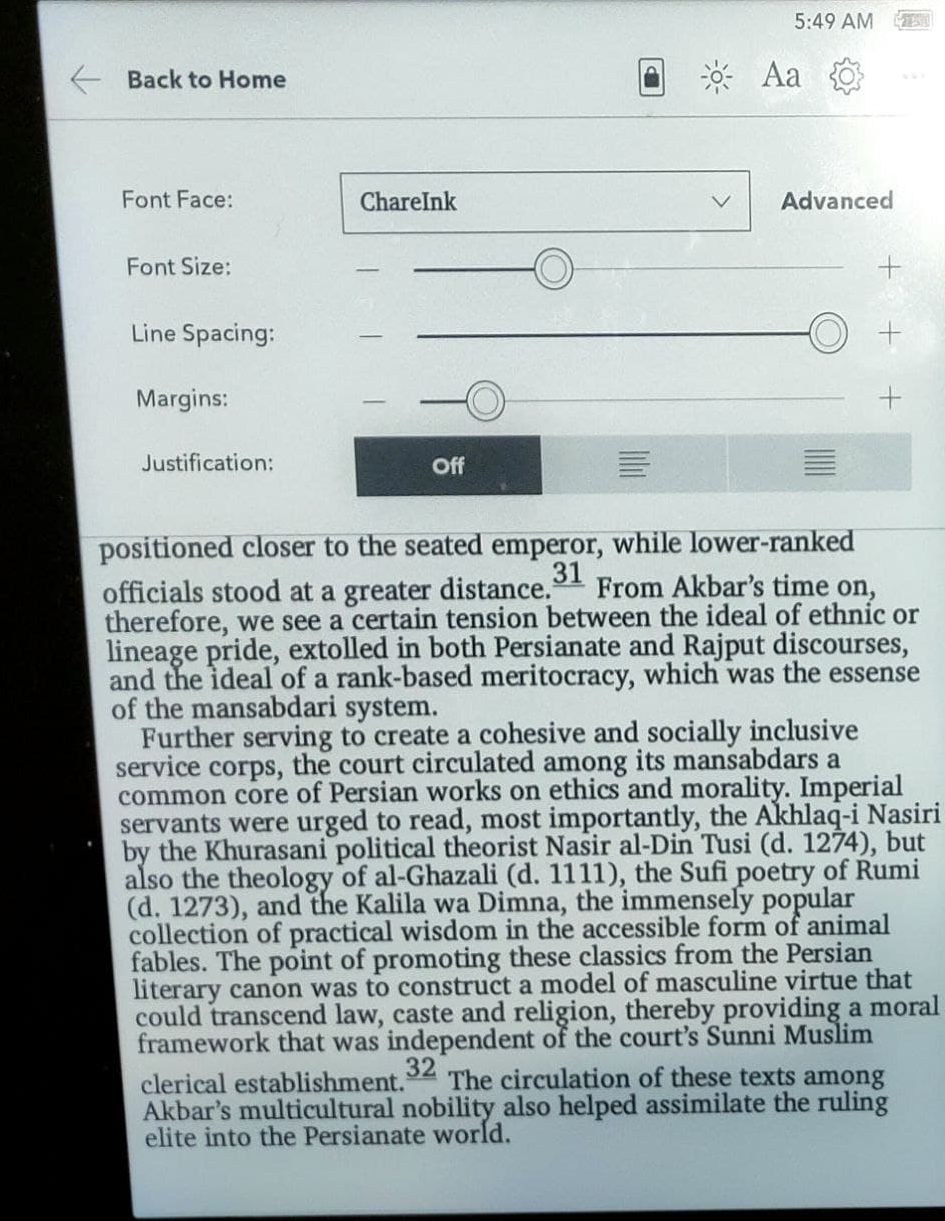

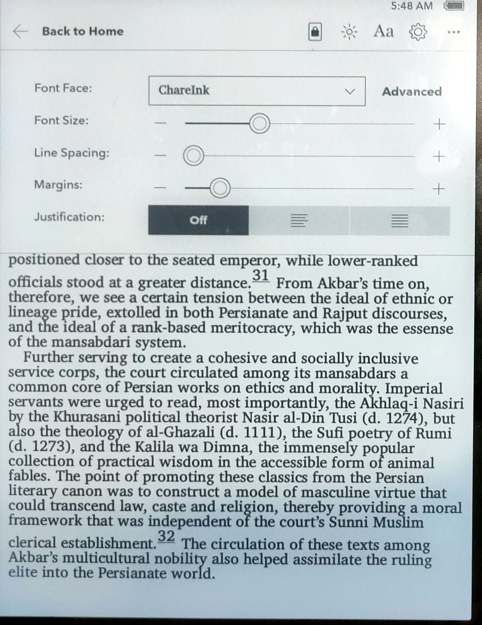

I removed the Store-bought kepub version of a book and sideloaded an epub instead, the same one I've been reading on my Libra using KOReader. It's a largish file, the retail kepub was 24MB, the epub 22, so in KOReader, there is a visible delay while changes to font size, weight, margins and/or line spacing take effect. But they all DO take effect. I've discovered that on my Sage, the same file accepts changes to margins, font and font size, but not line spacing, as the attached screenshot shows. The same is true on my Libra using the Kobo stock reader - font, font size and margins all respond to changes, but line spacing does not. What would cause this?

Hard-coded line-height in the css? Have you looked at it in Sigil or the calibre editor?
There's a patch for overriding line-spacing in the css.

You might have enabled the style tweak that bypasses line-spacing, or it might just be an odd CSS quirk (this is not my forte). The two (three if you count RMSDK) renderers work *very* differently, and they all have a different set of stock CSS and CSS bypasses, so, any "why does it work in X and not Y" question will always be answered by: "because X is not Y" ^^.

Take the ePub and go into the Calibre editor and remove all line-height lines from CSS. Then reload it and try again.Being abe to change the line spacing will work after this.
