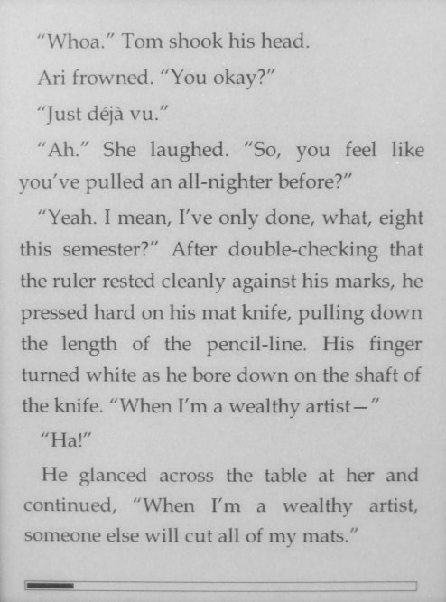

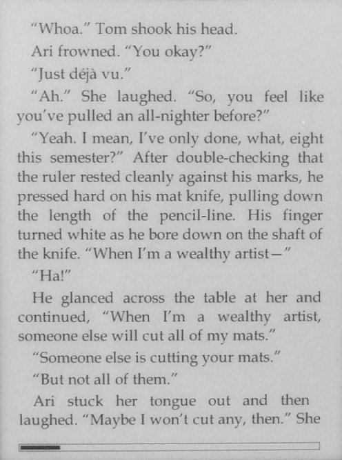

Here are two screenshots showing Book Antiqua before and after I changed the line spacing. I used the values -400 and 400.
EDIT: Made better screenshots, still Book Antiqua before and after though.

Originally Posted by IceHand View Post
Derek, you've got mail.
Impressive !
It looks MUCH better with this custom font.
