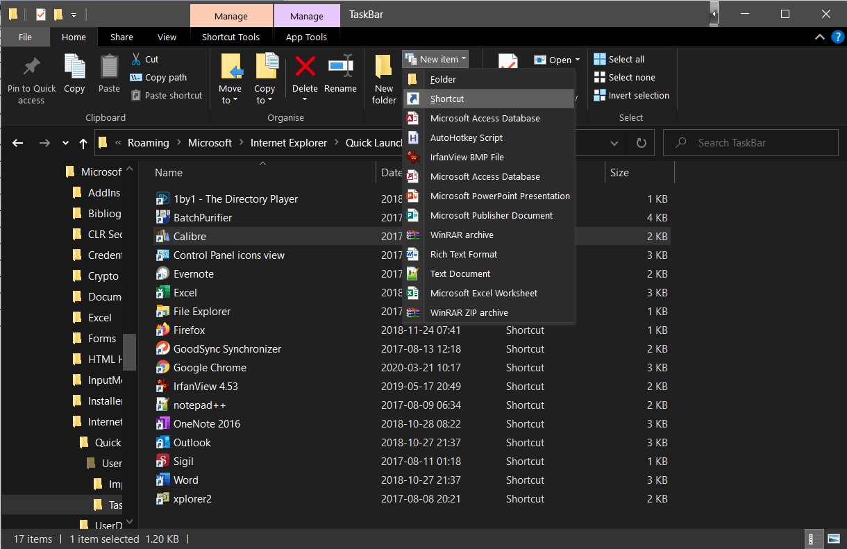

Try creating shortcut to calibre.exe in the %APPDATA%Microsoft\Internet Explorer\Quick Launch\User Pinned\TaskBar\
There's a 'wizard' for creating shortcuts in File Explorer, viz:

@BetterRed - Thanks for the suggestion. I could create the shortcut, but it did not appear in my taskbar (is it relevant that IE is not my default browser?). I'm still wondering whether over-writing my Appdata configuration settings on re-installation has anything to do with it? I mean, I can start from scratch and recreate them all, but I seriously don't want to.
No.

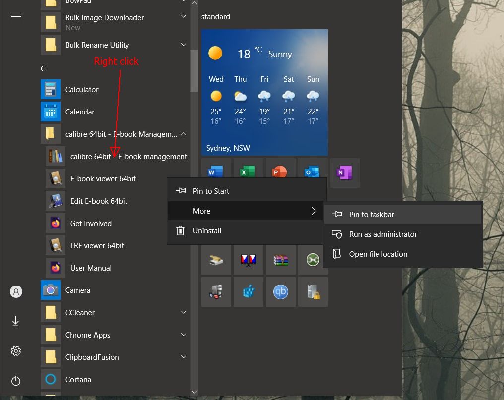

I just remembered - there's a 'proper' way to do this, viz:

So called experts often forget the bleedin' obvious
