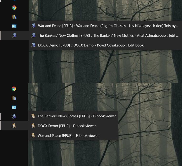

Originally Posted by AnotherCat View Post
Calibre Editor does the same thing it running from a shortcutted task icon (and I suspect the other Calibre bits when run stand alone in the same way would too).
Not for me mate - they combine into one icon, if started from within calibre or via File Explorer double click
In this shot the three editor sessions were initiated from with the book manager via the keyboard shortcut, and the three viewers were initiated from within File Manager (the calibre viewer is the default program for epubs)
I have Combine taskbar icons set to Always, Hide labels. I also run 7+ Taskbar tweaker, but it's not germane in this instance. And yes, I have tested my substantive issue without this gadget running - and not installed.
