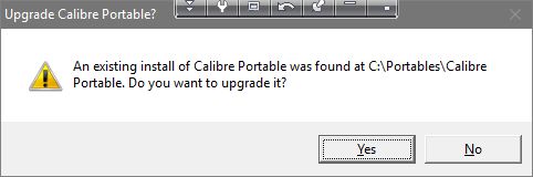

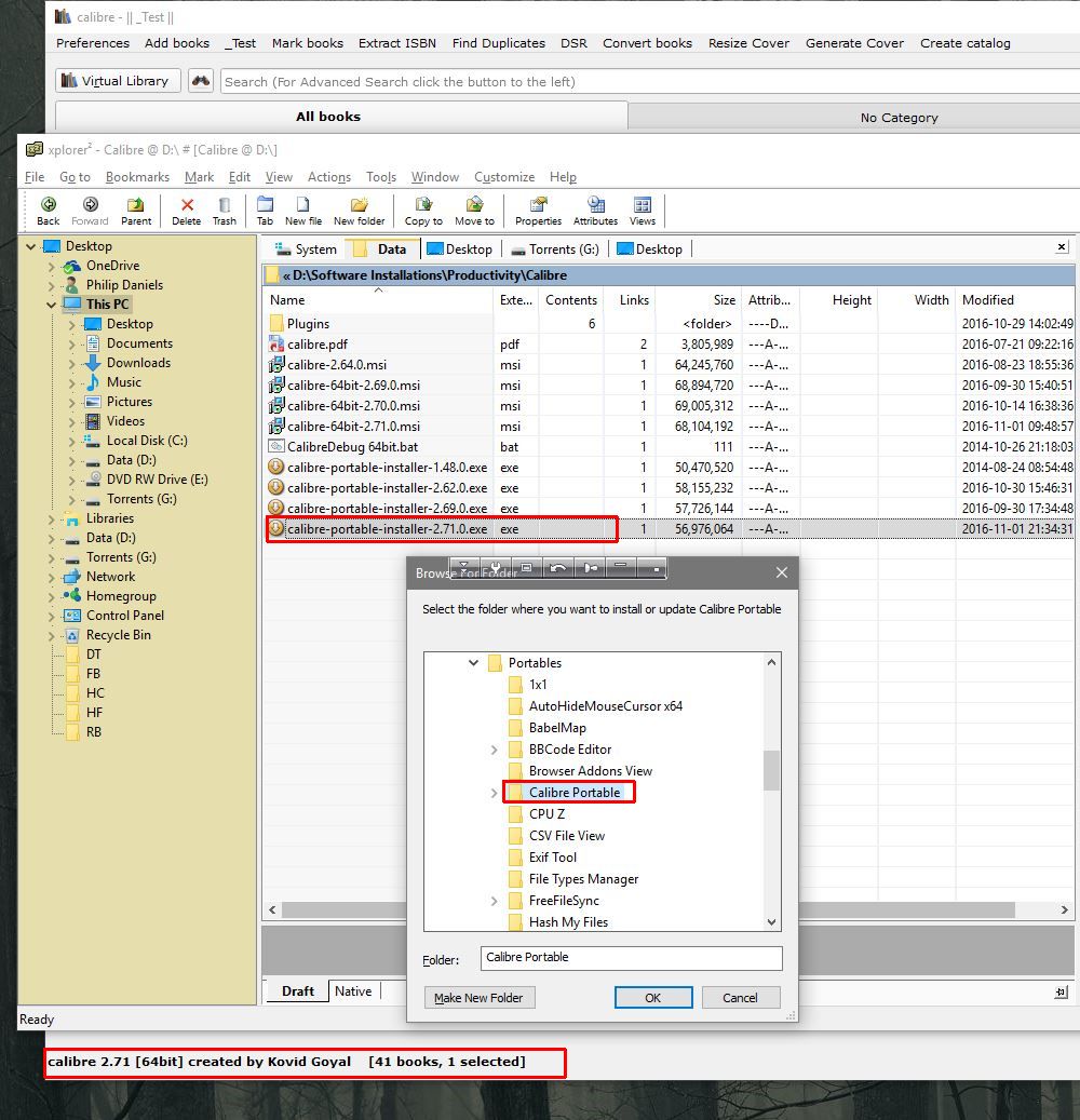

Here you see me starting to install calbre-portable-installer-2.71.0 into my C:\Portables\Calibre Portable folder

After clicking OK there. I get this (situation normal)

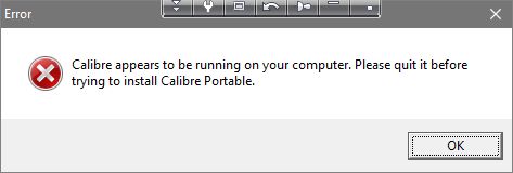

Then I get this

As for what benefit accrues from having a fixed uid, you'd have to ask Microsoft, I am simply following their recommended best practices. Off the top of my head, I'd guess, it allows windows to recognize common applications and save whatever ui specific settings are saved by the shell for applications, like recently openend documents, window positions, monitor it was started on, etc, etc.
But it more or less does most of those things already, has done for years.
All I know is that their so-called best-practice has made using your software 'awkward' for me.
I prefer to set a fixed starting UI config for applications(window size and position, optional panels etc), I would rather 'it' not restore the shambles in which I left it last time - rolled up in a corner half off the monitor. :lol:
Old 11-01-2016, 11:30 PM   #9
Posts: 46,576
Karma: 29634066
But that has always been the case, and it works by looking for a running process named calibre.exe, I know because I wrote the code that does that: https://github.com/kovidgoyal/calibr...aller.cpp#L469
It has absolutely nothing to do with application uids.
Old 11-02-2016, 01:02 AM   #10
Posts: 22,890
Karma: 34252744
I owe you an apology Kovid.
I don't know how many times I've installed portable, has to be a several hundred times (more times than the standard install) and I can't recall ever seeing that message. I must have unconsciously ensured calibre was closed every time. I know I do it consciously when I install a new 64 bit version, so somehow that discipline must have leaked over into installing portable.
That I never made that mistake until yesterday will bother me for weeks
Again my apologies.
