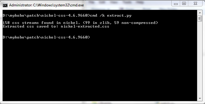

  4. Execute python extract.py it will make "nickel-extracted.css" file with streams (Windows file extract.bat for easy access). For example in 4.6.9660 there 158 stream with 99 compressed.

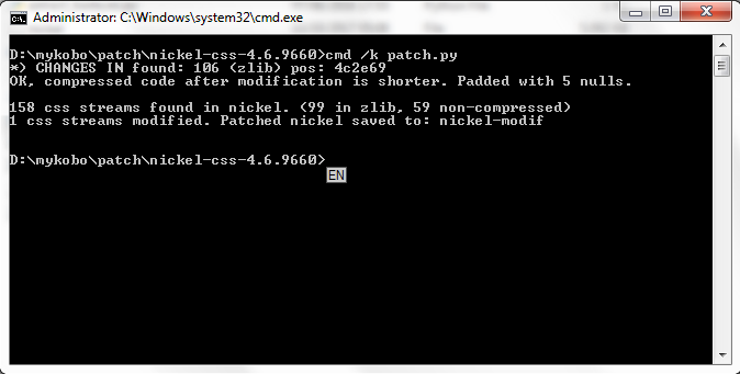

  7. I execute python patch.py (Windows file patch.bat for easy access). It will generate a new nickel file with the changes I made in the name "nickel-modif".

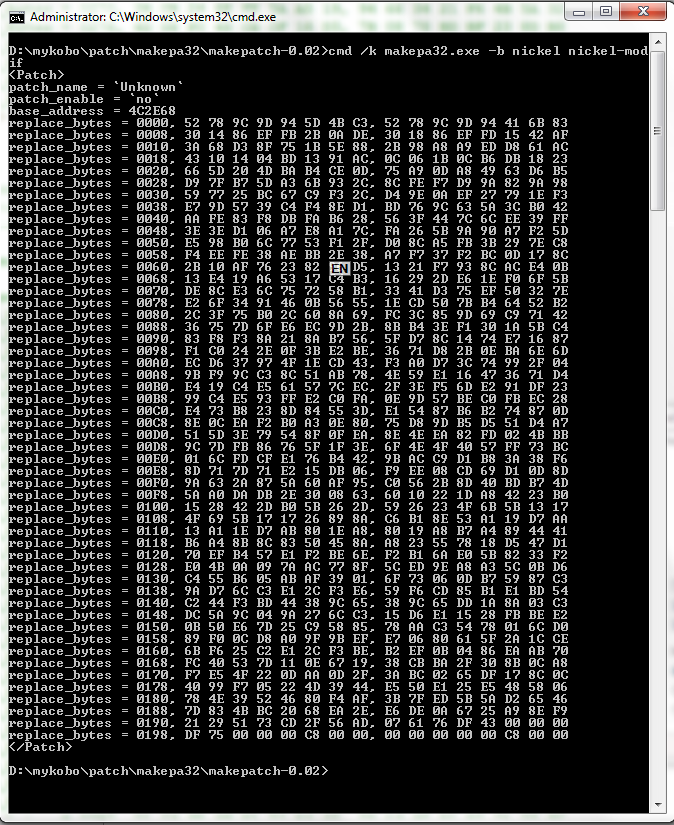

  8. Download makepatch-0.02.zip and extract as folder in your PC. Windows users can extract the file makepa32.bat from "bat files for windows.zip" to that folder.
  9. I copy the files "nickel" and "nickel-modif" to that folder. Execute the file makepa32 (nickel=oldfile, nickel-modif=newfile). (Windows file makepa32.bat for easy access).
    It will create patch `New home screen increasing cover size`.
    To copy the patch in windows, right click frame > Edit > Mark, mark the patch, press enter to copy.
  10. The patch is ready, copy the patch to file nickel.patch.
To make a patch from the same nickel file repeat steps 5-10.
