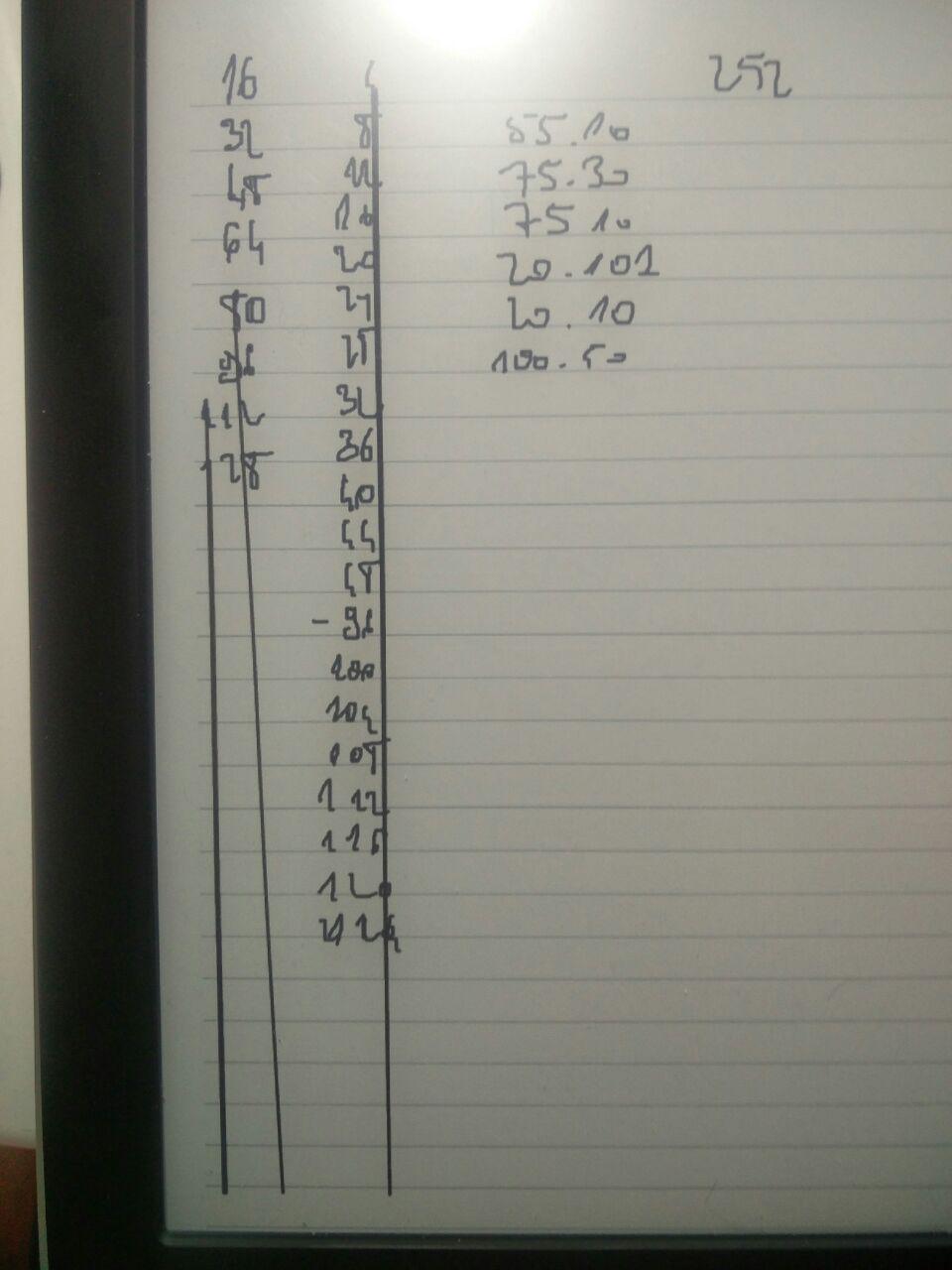

Hello,
I have exact same issue after upgrading to firmware 1.8.1 but to me the problem is when I try to write on scribble. From time to time I get some lines as I started typing from the down side of the screen... attached is a picture showing the problem I experience putting down some numbers.
The numbers 80, 112 and 128 on the left side had the issue as soon as I started writing them. You can notice the lines going to the end of the screen... very annoying and not sure why this is happening just after the firmware upgrade...

hi dear unclezero
in this pic that you attached
the boox having this line from first or when you upgrade this line coming?

Hi Metsal,
apparently after the upgrade. Never noticed this behavior before.
Uz

hi dear unclezero
i buy n96ml and update that set
and have a line in center of set
idont know this line coming from first day or after update that

Originally Posted by UncleZeno View Post
Hello,
I had this same issue before my tablet became unusable. I had the issue once after reflashing the firmware as described above, but since then I haven't had any issues. Hopefully it stays that way? Anyways, if it starts to cause a huge problem I would suggest trying that.
I've had both these issues as well. I say both, because I think I see two distinct problems:
1) The pen being "off" or not aligned seems to occur for me on cold startup of my N96ML and seems to go away once the tablet settles down (i.e. when the sd card becomes fully recognized, the wifi connects, etc.). After a little while, the pen acts normally for me, so I've just learned to not use the pen in the first few minutes after a cold start. There is also a calibration app for the pen in the settings app, I think there must be a calibration file that is corrupted or not fully read-in on start-up that may be to blame.
2) The scribble app making those lines, etc. has happened to me as well. For this problem it seems like the only way to clear it is to fully close and restart the app. This to me seems to be a problem with the app itself. With the new firmware there is also an app to update some of the built-in software, I'd suggest making sure that the apps are at the latest, as I have definitely seen bugs come and go each time a new version of the built-in apps gets updated.

After the upgrade to version 1.8.2 the issue disapperaed!
And it looks like everything is much smoother when taking notes. Absolutely happy about how firmware upgrades make the difference on this device.
