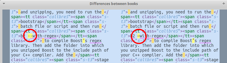

Discrepancy in >Differences between books<
Name:	b2 --with-regex.png
b2 --with-regex
It is known: pictures say everything. Even so, my comment: (Smarten Punctuation) That’s totally over the top!
"With all Good Wishes for Christmas and the New Year"
We still need you, as you know ... your chaot

Could you tell us what you actually did? Sure, there is a difference shown. But, you don't say how the difference window was opened. For all I know you are you comparing two versions of the book and one has two hypens, and the the other either an emdash or endash. That sounds reasonable as they are different.
I can take a guess that this is after doing a smarten punctuation in the editor. The other changes seem to agree with this and you vaguely mention it. If so, I don't understand the problem. Two hyphens/dashes together like that should get converted to an emdash. At least, that is what has been done in every punctuation smartener that I have used.
Have I missed the point? If so, please explain in detail what the problem is. And include all the steps needed to reproduce the problem. If you think, "Should I include that detail?", the answer is "yes". And a sample file is always helpful. Maybe a before and after file?

OK, context: I am writing a book! Both, the subject of the book (regular expressions) and the manual process to produce an EPUB is still largely unknown. Nevertheless, the progress I find remarkable - with confidence, I gladly announce the presentation for Christmas 2017.
These regular expressions are very useful for text editing, HTML & CSS are mandatory anyway. Well, a secondary aspect is that the brain cells get trained.
I thought this had been sufficiently indicated →... (Smarten Punctuation) ...
Yes, Boost's get transformed to Boosts (Typewriter apostrophe get transformed to an apostrophe. Correct!?)
That's the point: Even if it is what has been done in every punctuation smartener that you know. Here, this kind of smartening makes no sense: the text will be alienated.
I have discovered the matter only by chance, the book got over 300 pages.
God knows what else has been 'smartened'?
Does there exist a list what kind of 'things' get smartened and how - before/after status!?
Sorry, I don't follow that statement. You are writing a book about a subject you don't understand? If so, why? And why would I, or anyone else, want to buy a book from someone who wasn't an expert?
Or do you think that "regular expressions" are little known? If so, really?
Nevertheless, the progress I find remarkable - with confidence, I announce the presentation for Christmas 2017.
You might think that was obvious, but it wasn't. How hard would it have been to say: "I ran the Smarten Punctuation tool and saw these results. I don't think this is correct." And then explain why you don't think that it is correct. Because I couldn't see any problem in the image you posted, I had read your original post several times to find out what you were complaining about.
Yes, that's the point. The Smarten Punctuation works like every other Smarten Punctuation out there. Otherwise people would be raising bug reports because things like two hyphens together did not get converted to an emdash. Unfortunately, you have a situation where the double-hyphen isn't supposed to be smartened, but that is probably rare.
I have discovered the matter only by chance, the book has over 300 pages.
Sorry, I don't know. I assume that calibre uses a standard library but would have to hunt through the code to find it. I don't think there are any options to control it. You could try Diap's Editing Toolbag. This is an editor plugin and includes a different smarten punctuation tool. It does have options for handling double-hyphens.

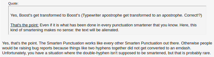

Name:	That's not the point.png
That's not the point. Unfortunately, MobileRead suppresses quotes in the repeating citation.

Attachment 153850
Yes, four times as many letters were needed. And if they had been used, think how many less would have been needed in the answers.
My point was that your original post was unclear and I had to take a guess as to what the problem was.
