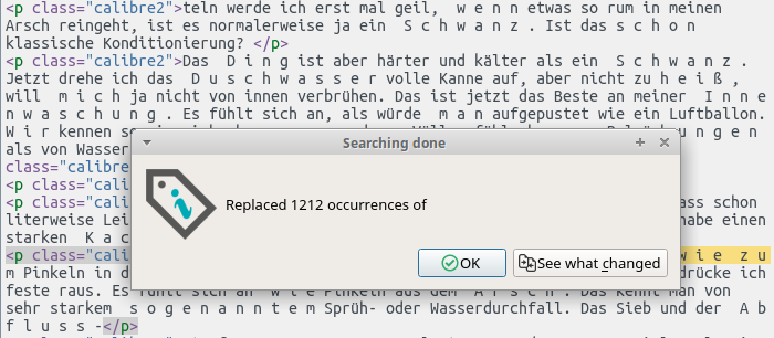

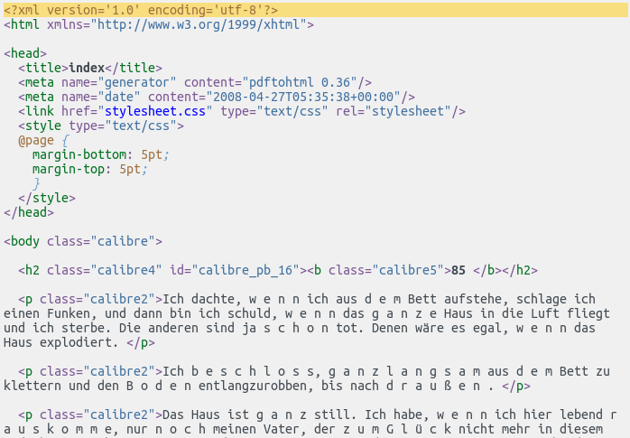

With F&R (Find and Replace) (in MR also called S&R (Search and Replace)) I want to reduce double spaces to one, with command Replace all. I repeated the procedure several times, waited, no changes!
Find: *SPACE**SPACE*
Replace: *SPACE*
Name:	Searching done_1212 occurrences.png
1212 occurrences

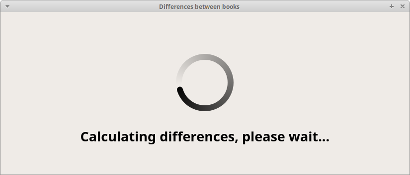

Click: See what changed
Name:	Calculating differences, please wait.png
Calculating differences, please wait This window does not appear!?

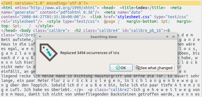

REGEX \s\s might work, BUT it might also get line ends
I chose this approach.
Run Fix HTML - all files & Beautify all files
Find: \s\s
Replace: *SPACE*

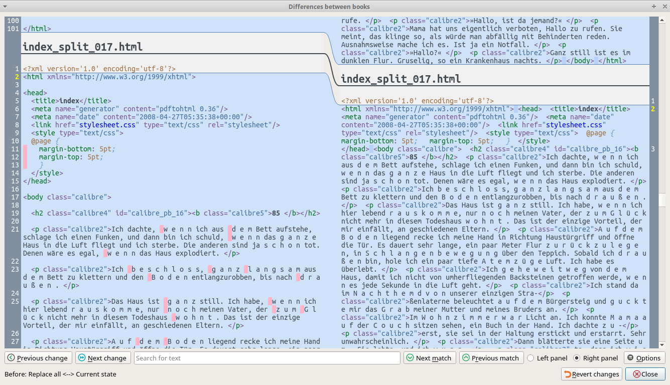

Name:	Replaced 3494 occurrences.png
Name:	Differences between books (example).png
Differences between books (excerpt)

Run again Fix HTML - all files & Beautify all files

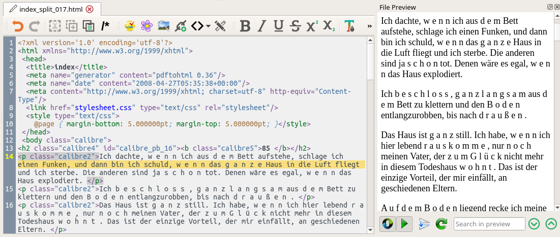

I think the pink blobs in the third shot probably indicate the presence of a 'special' space character. In codeview window, position the cursor immediately after a blob and the character details will be displayed at the right end of the status line.
What does the fourth shot look like in Preview - it appears to have a space between almost every character - but if that's what you want I guess it's OK.

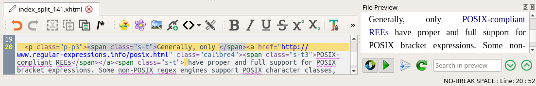

Never mind which white or blanc spaces or plainspaces, the regular ones, the ones in some words or the double ones between the words: all called SPACE (in status line).
EDIT Soon my head is also an empty space - yet it hums.
There are NO-BREAK SPACES, colored yellow.
Code View (Yellow space)
Name:	NO-BREAK SPACE.png
NO-BREAK SPACE (Cursor behind yellow space)
No! What I want is: One (normal) white space between words, none in the words.
