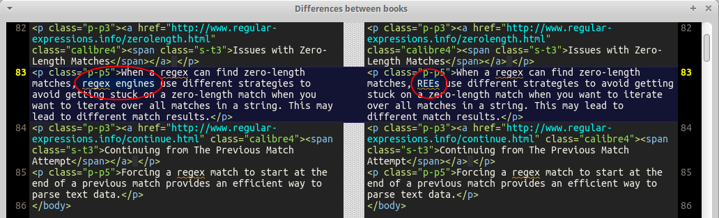

Differences between books - Color of markers
Name:	Differences between books.png
Differences between books Markers poorly visible
Can I change the color of markers and where?

I don't use 'marking' myself.
Oh, could it be that we talk at cross purposes. It's Edit book→F&R and Replace all→Differences between books, that marks the replacements (and the markings).

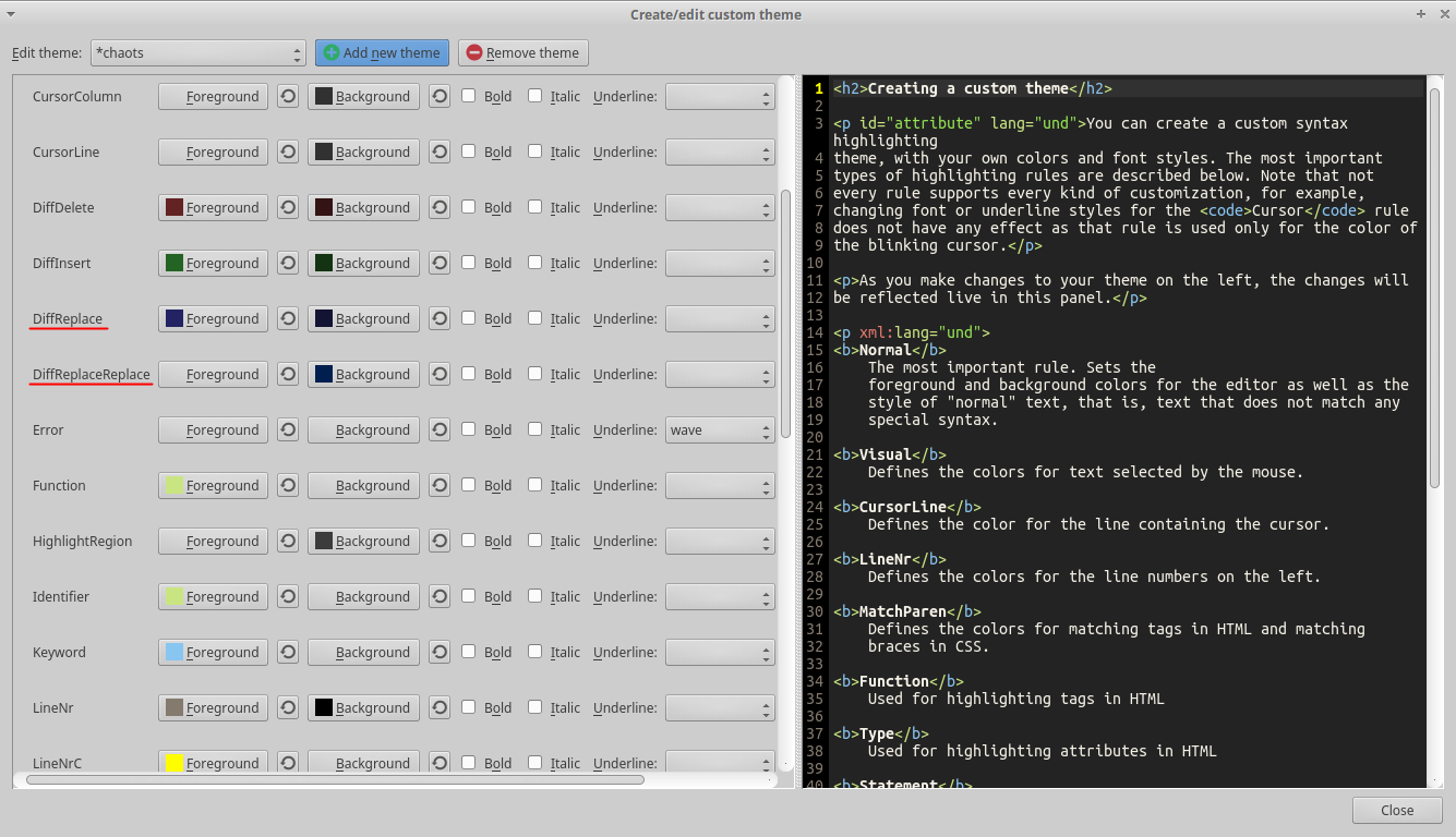

Name:	Create_edit custom theme.png
Create/edit custom theme
which I changed drastically
Name:	DiffReplace(contrast colors).png
DiffReplace Contrast colors
The wombat-dark experiments have shown it is DiffReplaceReplace / Background.
Color theme pyte-light DiffReplaceReplace / Background yellow
That was a pretty time consuming exercise - could end up totally frustrating, if it had turned out that the spezific color for replacements-markings in Differences between books is immutable.
