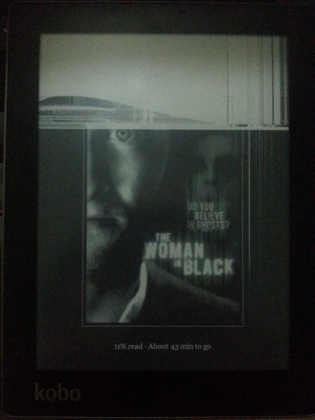

I have this Kobo Aura, all touch screen works properly but some part of screen isn't being read even touch works. Is there any script to use this device like 5", I see some codes but they are for Aura HD, I think.
It takes 90$ new touch screen.
And I am sorry about ghosting this topic but I didn't want to create new one.
Thanks.
I guess you are aware of the fact that the above codes work only for "alternative readers". The first is for Koreader, the second for Coolreader. I do not know whether you are willing to use one of these, and if which one. If you would like to try and you do not have any preference, I would suggest using Coolreader in this case, since the modification seems to be easier to do (and I have tested that it works).
As for the values I would propose you try
exec cr3/cr3 -stylesheet $STYLESHEET -geometry 758x760+0+254
This would skip roughly the top quarter of the screen.
Be aware that using alternative software and doing modifications might brick your device. Since the Aura has no exchangeable internal memory, it is even more dangerous.
