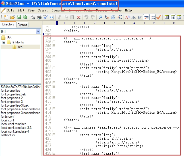

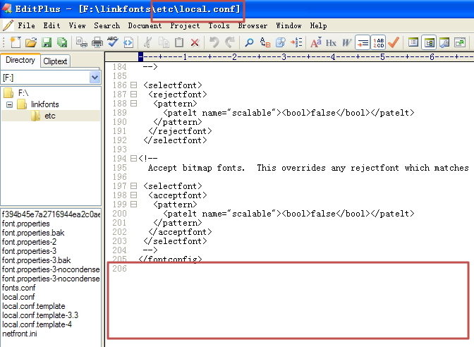

@donnie888:
* Yep, delete nobrowser, then reboot.
* If that still doesn't help (it should at least work for Latin scripts, though), delete the few zh/ko overrides near the end of local.conf (~L394-444), then reboot (or autoreboot).
Thank you NiLuJe!
I tried as your guide, the result is:
1) delete nobrowser, reboot process about 5minutes, but nothing change for my question, it seems no help for it.
2) I found local.conf file is with content less than L206, without L394 and more. But in another file local.conf.template is with L394-444.
How should I do? Replace local.conf with local.conf.template is right?

@donnie888: I'm assuming you're running FW 3.4, right? And that you checked local.conf *after* the reboot? And that you're not using a custom prettyversion.txt with a weird syntax?
