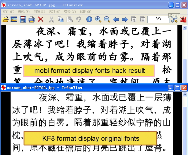

[QUOTE=NiLuJe;2226052]... Another small update? Yay?! Fonts v5.4.N!
Hey, dear Mr. NiLuJe, I appreciate your efforts on kindle fonts hacks.
However, I met a problem on KF8 format books.
A same book that I transferred to mobi format and AZW3(KF8) format by calibre software, the mobi format can display the right font hack result (CJK.ttf that I replaced); but the KF8 format lost the hack result and display original font.
Would you please tell me how to do to let KF8 format books display a right font hack result?
Thank you very much!
donnie888 is offline   Reply With Quote
Old 09-16-2012, 11:18 PM   #2518
NiLuJe
BLAM!
NiLuJe's Avatar
Posts: 13,507
Karma: 26047434
Location: Paris, France
@donnie888:
If you really want to be able to tweak the browser fonts, and don't care about the overhead involved, just remove the nobrowser file in the linkfonts folder, and Restart your Kindle, and wait. A lot. NOTE: Because regenerating the cache takes so much time, we won't try to handle the browser fonts by default, in order not to waste 5 minutes each font switch.
Important note about KF8 files: Please note that in order to use your custom fonts in KF8 files, you will *have* to enable this feature! You'll also want your font's metadata to be consistent: for example, all the Serif fonts should be of the same family, and their styling info should be accurate, or you'll risk having strange surprises, like books rendered in all bold .
That might or might not be enough for CJK fonts though, you might have to tweak the ko & zh overrides in the fontconfig setup... (linkfonts/etc/local.conf)
Old 09-16-2012, 11:34 PM   #2519
donnie888
donnie888 began at the beginning.
Posts: 7
Join Date: Jan 2012
Device: kindle3
@NiLuJe
@donnie888:
Hey, Mr. NiluJe, thank you for your quick reply.
But I still feel confusion how to tweak the setting parameters.
Do you mean the step by step like below:
1) Remove the nobrowser file in the linkfonts folder first?
2) How to enable KF8 feature?
3) Which contents that I should change in local.conf file?
Best Regards!
Old 09-16-2012, 11:50 PM   #2520
NiLuJe
BLAM!
NiLuJe's Avatar
Posts: 13,507
Karma: 26047434
@donnie888:
* Yep, delete nobrowser, then reboot.
* If that still doesn't help (it should at least work for Latin scripts, though), delete the few zh/ko overrides near the end of local.conf (~L394-444), then reboot (or autoreboot).
