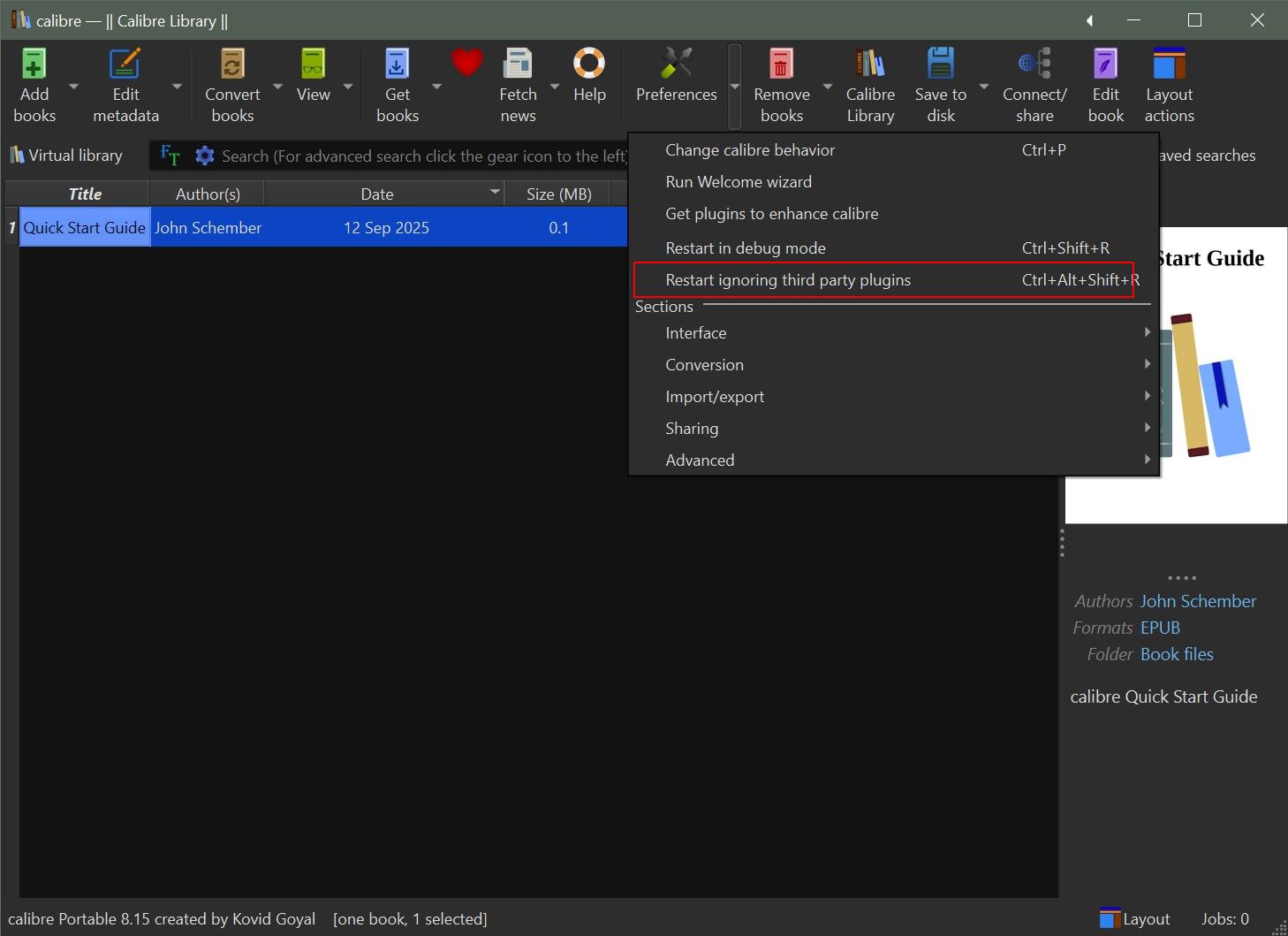

Did you try a restart with no plugins?
Attachment 219396
Yes, see my original post. Starts up fast.
