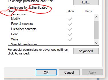

Old 11-23-2025, 09:31 PM   #15
Posts: 31,565
Karma: 62543878
Look for that folder INSIDE the (each if more than 1) Library folder and mak sure of the .caltrash permissions.
