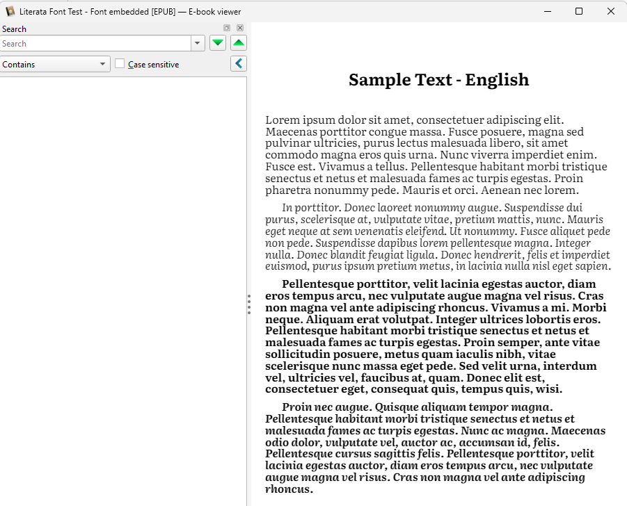

When I opened your test book with Calibre Viewer on my Windows 11 machine, I didn't see cursive text on the last test page.
