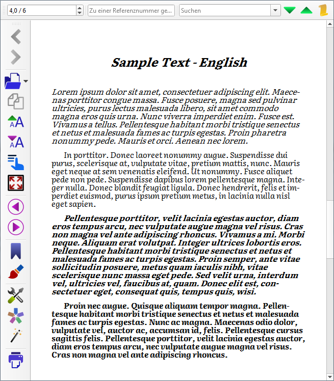

Originally Posted by Slevin#7 View Post
Italic was never the problem, it is that regular text (font-style: normal) is displayed as pseudo-italic, not even showing the proper italic font but skewing the text somehow.
All is ok with the epub you uploaded; this is how it looks in Calibre Viewer 8.4.0 under Linux:

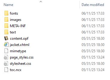

you have a URL( ..\fonts
I think it should just be URL(\fonts
In calibre, you can select the book and tap 'U' to unpack, then explode and look at the top level structure .
I think yoy backed up (the ..) too far and the font was not found, thus default

I don't know which eBook's structure you've attatched to your post, but it doesn't seem to be mine nor DNSB's. However, the issue is not, that Calibre won't find the font, it does and displays the correct font as well, the issue is, that Calibre skews the regular fonts by itself for whatever reason. And this affects, at least as far as I could find out, only fonts downloaded from Google Fonts. If there were a structural problem, Calibre would not only not find the Google Fonts (and magically materializes them somehow skewed), it would also not find Liberation, which it does and displays it as expected.

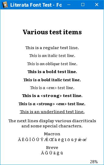

When I opened your test book with Calibre Viewer on my Windows 11 machine, I didn't see cursive text on the last test page.
