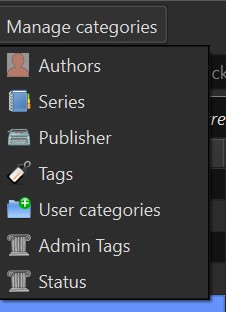

You also clobbered many of my custom keyboard shortcuts - see attachment.
Plugin removed, they seem to be back.
Added: Manage Categories is a core calibre feature, IMO we don't need another one
Attachment 214421
Fixed, sorry for that. Now I have set the plugin to register just one empty shortcut for main dialog that users may customize. Tab and space can be used to navigate through buttons as usual.
