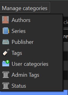

Originally Posted by Comfy.n View Post
Thanks for your recommendation, BR.
I have uploaded version 1.3 which hopefully meets your suggestion.
I have also adjusted some custom icons that were not properly referenced, hope you folks like it.
You also clobbered many of my custom keyboard shortcuts - see attachment.
Plugin removed, they seem to be back.
Added: Manage Categories is a core calibre feature, IMO we don't need another one
Name:	Screenshot 2025-03-18 195652.jpg
Attachment 214421
Fixed, sorry for that. Now I have set the plugin to register just one empty shortcut for main dialog that users may customize. Tab and space can be used to navigate through buttons as usual.
