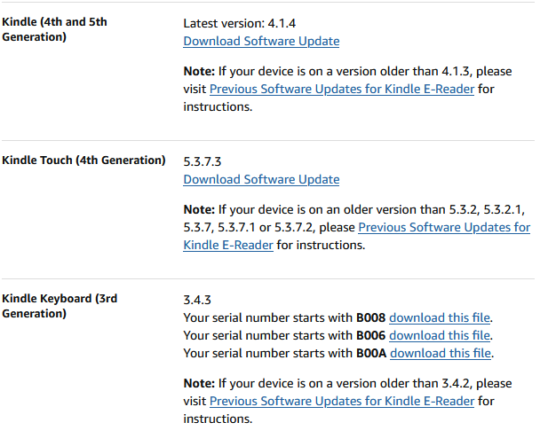

Posts: 81,053
Karma: 150250983
Originally Posted by Frogm4n View Post
Unless you are keeping it back for some reason, you should install the firmware updates for it. Since it's pretty far behind you'll have to install them stepwise to get up to the latest for it. You'll need to install them manually, too.
Why can't the latest firmware be installed without going stepwise?
Because in the early years kindle firmware updates only replaced a subset of files instead of the entire OS and data files like now.
If you look at the Kindle firmware updates page, you will see quite a few of the older Kindles have entries such as the ones in the image below where you have to go stepwise to get to the latest firmware update from an earlier one. The explanation I read several times on MobileRead over the years was that to keep the size of the firmware updates down, the firmware updates were only the needed files to update from version x.xx to x.yy.
