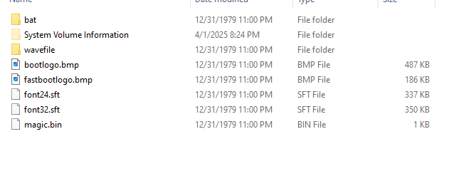

Hoping I could get an SD Card Image for my 37NB-E70P1M+6B2 system. I managed to extract the SD card from the reader but after plugging it into my pc this was all I could find.
To explain the issue I've been having, my system would be stuck in perpetual booting no matter what option I pressed from the Safe Boot. Even resetting the system didn't work. Instead, the following message would appear in the bottom left "Supported API: 3
Rebooting..."
I've sat the device down for +24 hours hoping it would eventually reboot but no dice.
