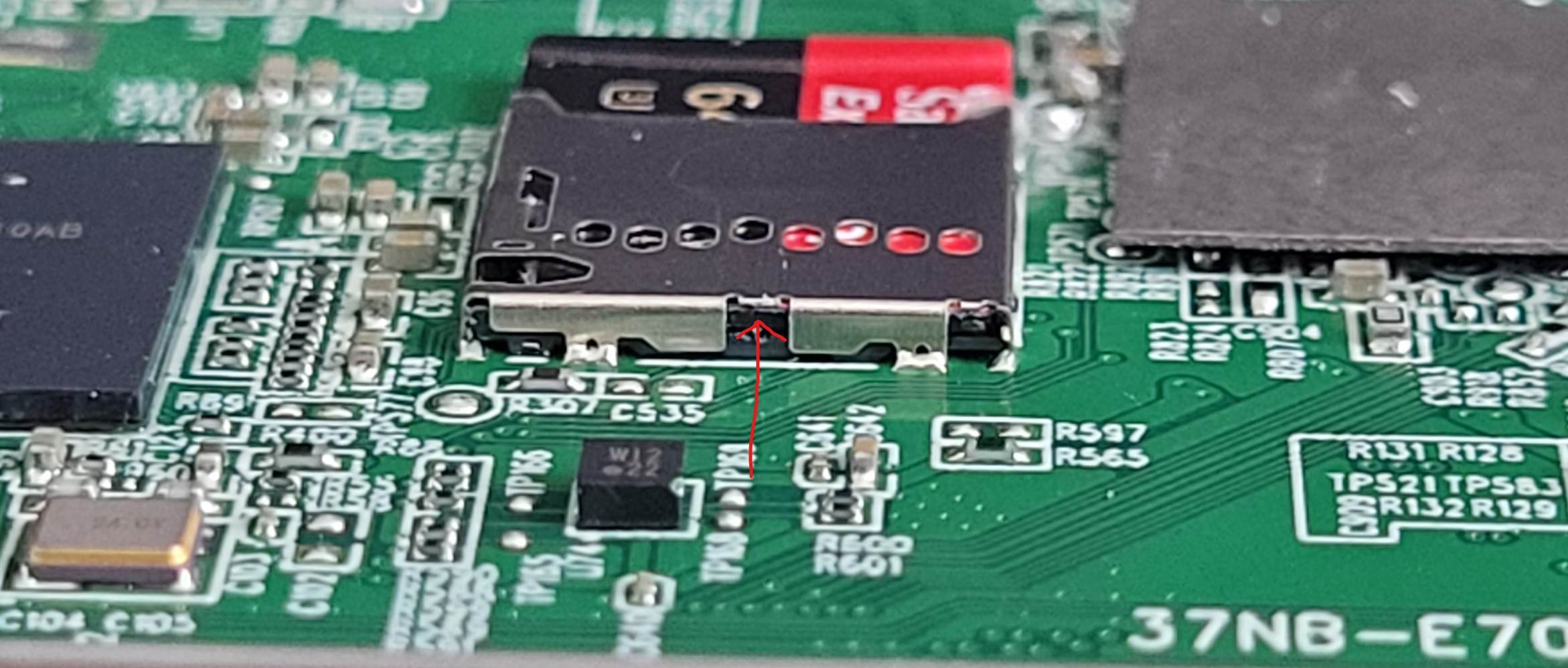

The next step was to push the card out from the tiny hole at the bottom side of the socket. I used a very sturdy and good quality SIM card pin (from the fruit brand phone). Be careful not to damage other components of the PCB while you are doing this. The key here is to be firm and steady when you apply the force to push the card out. Make sure the pin is pushing against the card and not the PCB board.

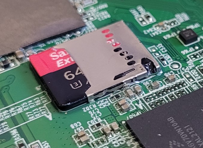

Photo of the sdcard with the coating, can't really see it under normal lighting other than some parts being shiny.

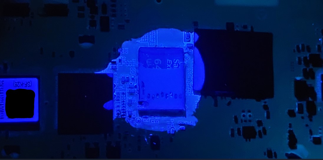

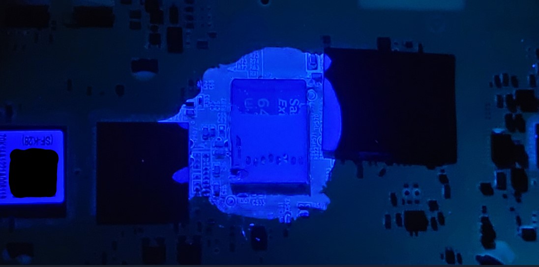

Below is the photo of the coating under black light, since my coating has UV tracing.

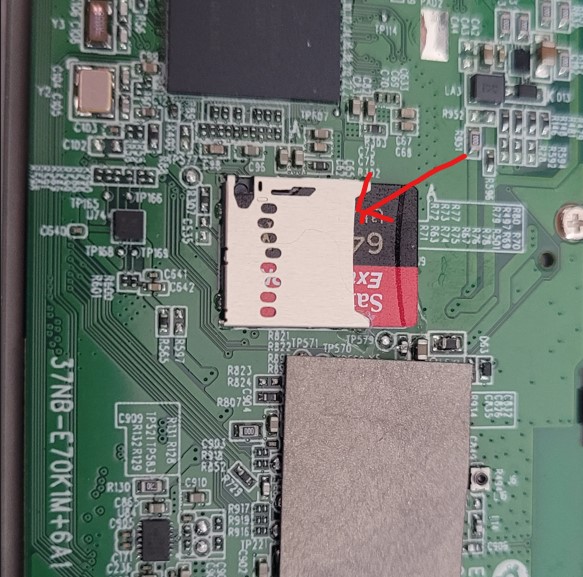

The result after the sdcard was swapped.

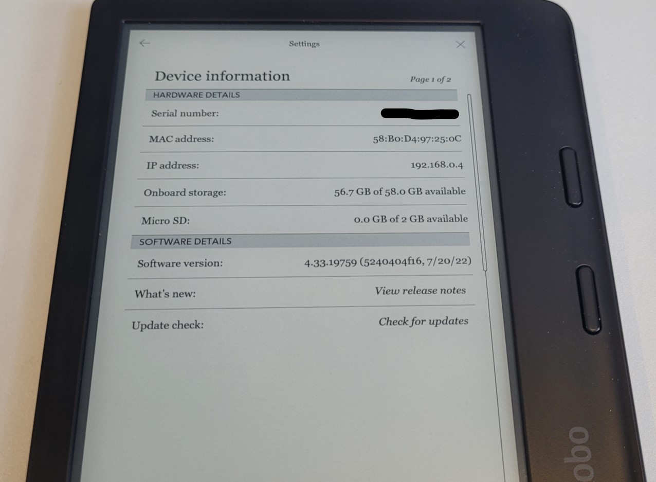

I'm curious why there is an extra MicroSD item in the storage section.
To be honest I have no idea . I wonder if someone can help explain it. Maybe the software I used did something weird to it when I clone it to the new card. But everything works fine so far

Can the 99% isopropyl alcohol dissolve the glue?
Yes it can but still need a bit of rubbing/wiping to remove the residue.
