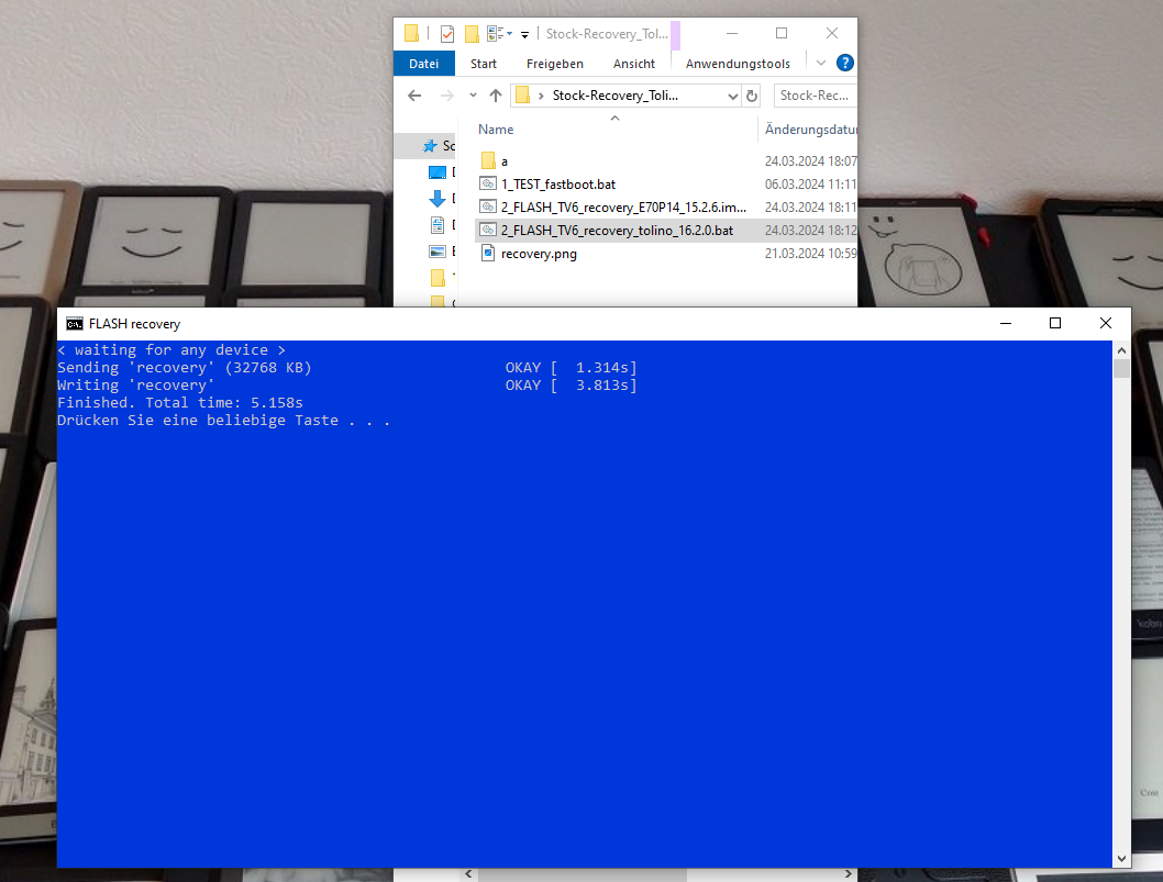

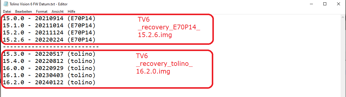

upd... We perform all the steps described below with a cloned card. ...upd
Then install TV6_recovery_tolino_16.2.0.img.
If during recovery it gives an error like in the video, then you need TV6_recovery_E70P14_15.2.6.img.
Now only tomorrow I will write what needs to be done in this case.

Originally Posted by litrpguy View Post
Thanks Waldy, my device probably has some serious issues as i can't copy from and to the device but I'll keep trying all of your suggested solutions
And you also cannot boot the device into recovery mode using hardware buttons?
You can flash it in another way.
https://mega.nz/file/fwchAQKR#AZ6mAx...mHBZ_P6U8na5Ow
We connect Tolino to the PC.
Turn off Tolino by holding the power-button for 10 - 15 seconds.
Click 2_FLASH_TV6_recovery_tolino_16.2.0.bat.
Now use the buttons (bottom page turn button + power-button) to boot into fastboot until the command is executed.
Next, disconnect the Tolino from the PC and, using a long press on the bottom page turn button + power-button reboot from the mode
fastboot to recovery mode.
ID:	207151   Click image for larger version
I'm currently able to flash it via 2_FLASH_TV6_recovery_tolino_16.2.0.bat, able to boot into recovery mode now. Thanks for this help! Will retry your prior suggestions
