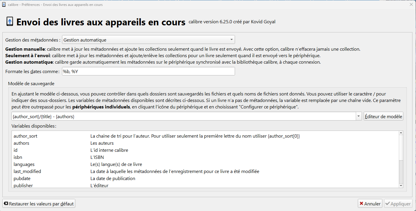

Do you have metadata management set to automatic management under Sending books to device? See attached image.
