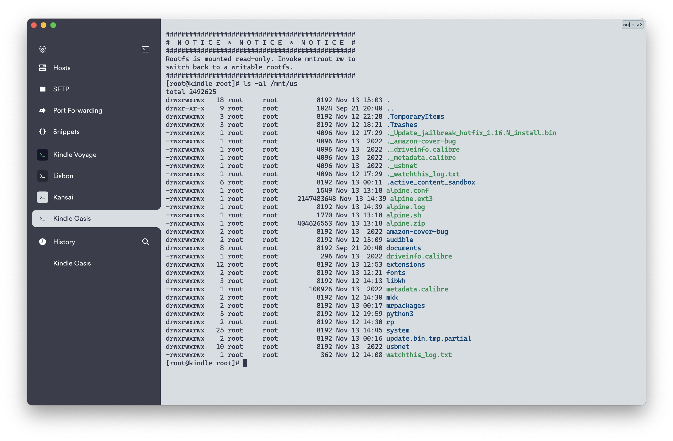

After a long period of absence, I was glad to learn about WatchThis JB yesterday. Thanks to @katadelos, I managed to JB my Kindle Oasis (9th Generation) yesterday. Installed JB Hotfix, MRPI, and KUAL, and then instead of installing custom packages from scratch, I copied my current ones from my Kindle Voyage.
Fair warning, though: this will *no longer* protect you from automatic updates on FW >= 5.12.x! On those FW versions, slightly more aggressive methods are in various phases of development, check the forums (e.g., https://www.mobileread.com/forums/sh...d.php?t=327879).
While playing with SSH over WiFi happily thanks to USBNetwork, I received the official OTA FW 5.15.1 update. So, I confirm that PREVENT OTA Updates doesn't work on FW >= 5.14.2.
Keep in mind than an official FW update will basically throw you back to the post-hotfix step: you'll basically have to reinstall anything that came bundled in a .bin, except for the hotfix/bridge itself.
On a happy note, I also would like to confirm that JB Hotfix helps and JB survives the FW update. Thank you once more @NiLuJe.
However, having installed everything from scratch this time using @NiLuJe's Snapshots, I have noticed that USBNetwork had stopped working. Not that it doesn't work actually, * SSHD is up (usbms, wifi only) *. But I am asked for password although I have /mnt/us/usbnet/etc/authorized_keys in place. Code must have changed between versions 0.22.N @18289 on 2021-Mar-25 @18:22 and 0.22.N @18981 on 22-Oct-02 @03:32. I switched back to v 0.22.N @18289 copying the files I have backed up. All is fine.
Any pointers would be much appreciated for I would not like to go back to SSH over USB to configure USBNetwork from the start.

@oumlaut: Unless you switched to OpenSSH, the fact that it *rejects* a password tells me you might simply not be connecting to the right IP .
The default setup uses dropbear and will accept *any* input as the password (so, just hit enter).
(Keep in mind swapping the config manually is *not* safe outside of USBMS mode. i.e., doing it live over SSH will result in undefined behavior).
