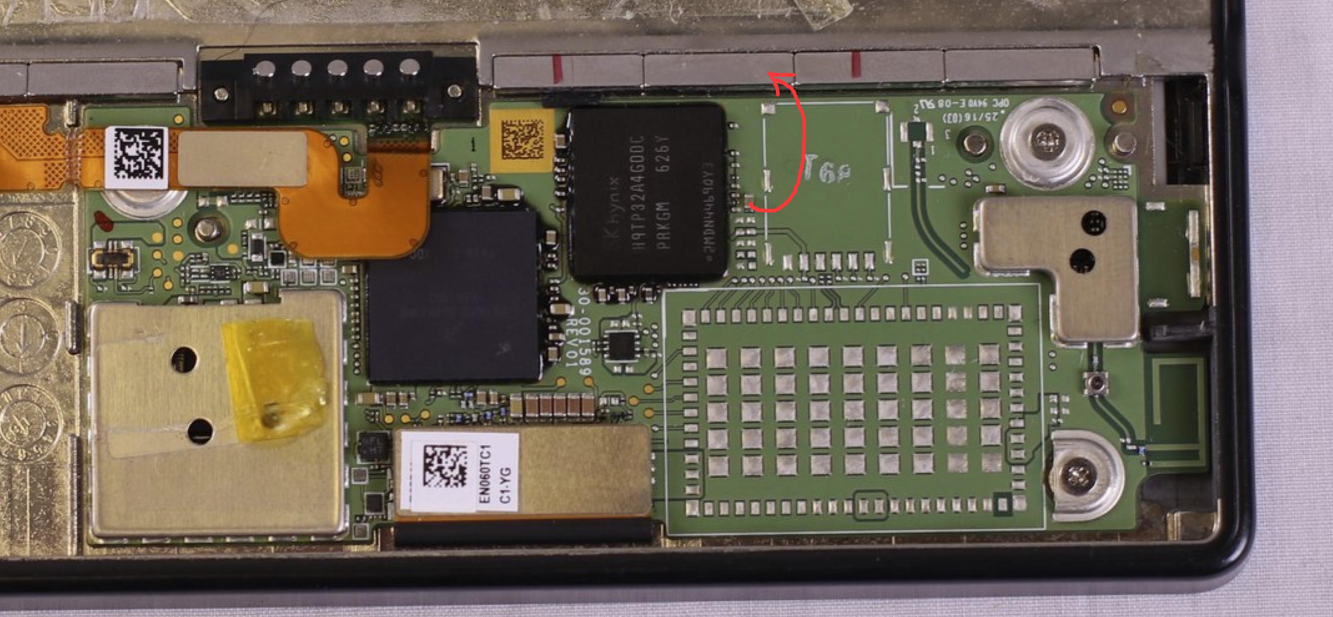

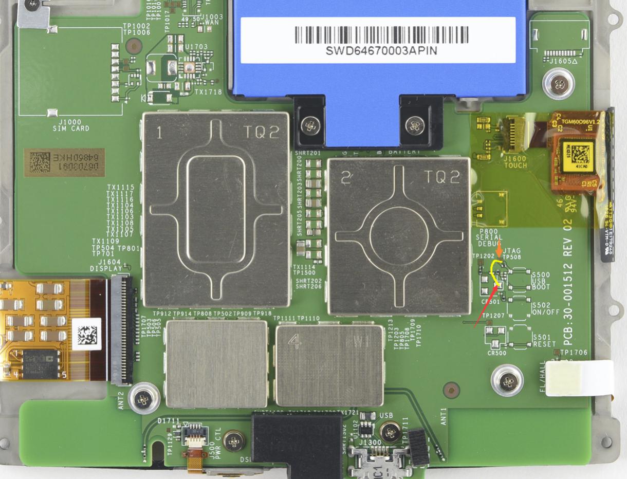

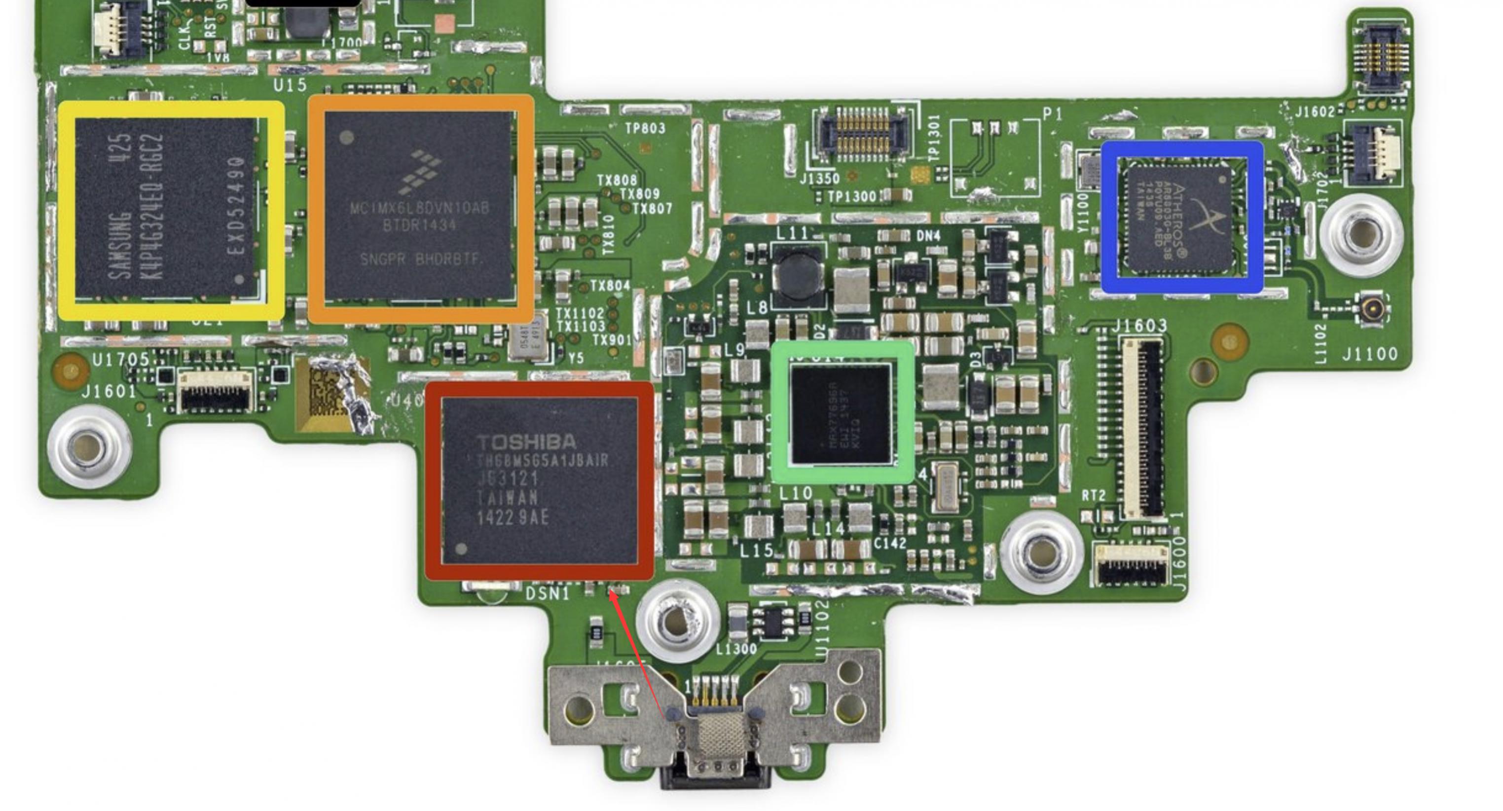

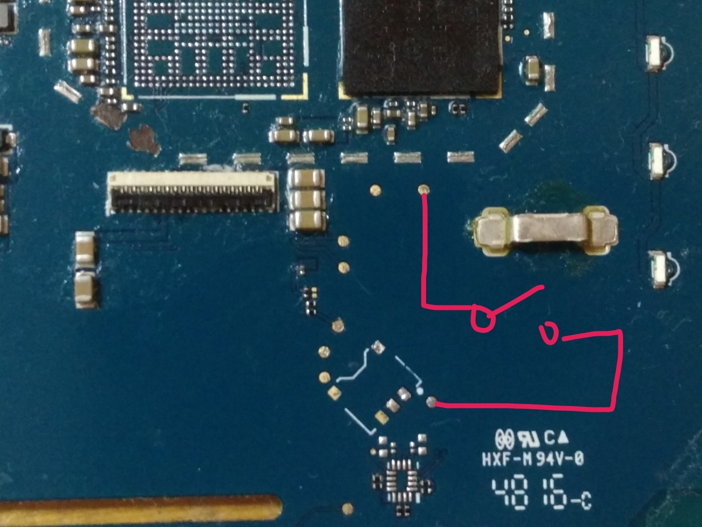

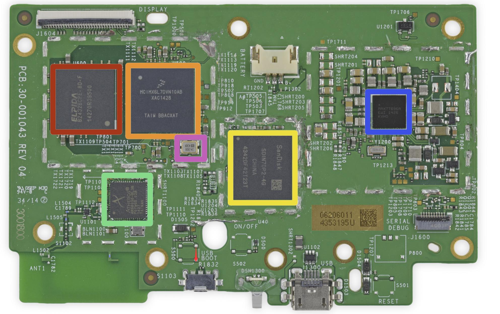

To use this jailbreak, you will need to open up your device, attach your device to your host PC using a USB cable and activate SDP mode. There's a number of ways that you can do this, with some being easier than others.
Without removing PCB (KT2, PW2, PW3 only)
After removing PCB
  • KT2, PW2, PW3: Connect a wire from TP1706 to TM401 and reset the device.
  • KV: Connect a wire from TM500 to TM501 and reset the device.
If you have done this correctly, you will see something similar to this when running dmesg on the host PC:
