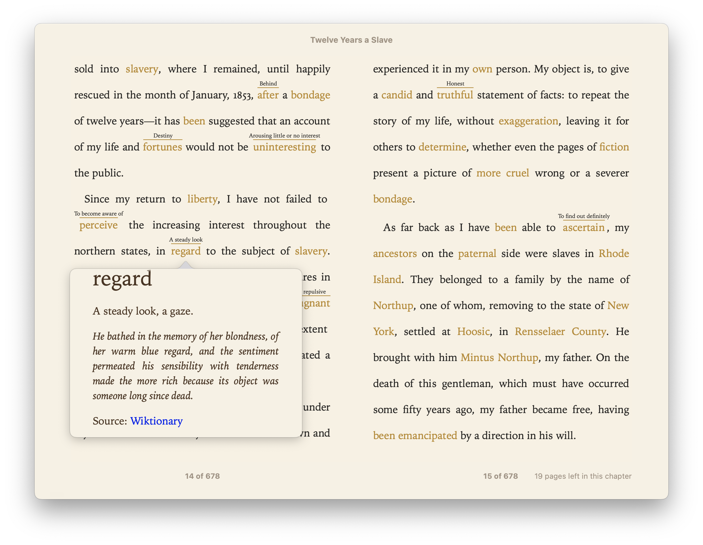

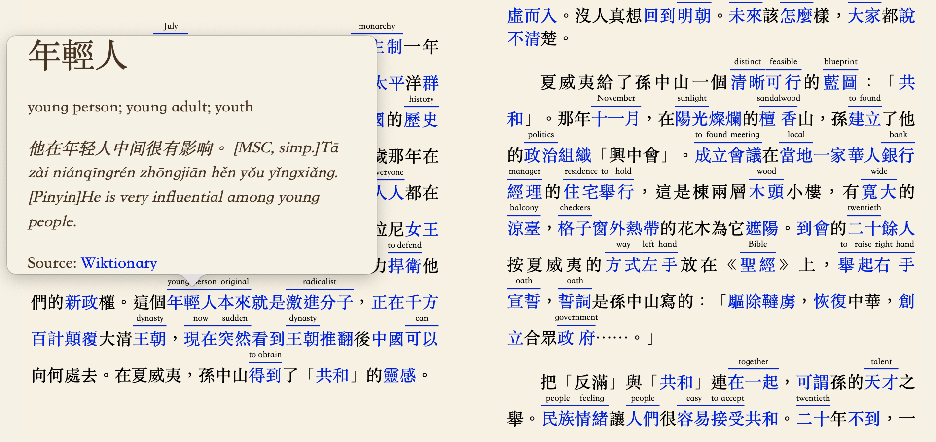

New test feature: Word Wise for EPUB books. It can be downloaded from GitHub Actions.
I use the Wiktionary data from https://kaikki.org, the English JSON file is 1.4GB, other language files should be smaller then that.
I only enabled this feature for the 21 languages that have the spaCy model, but this feature could work for any language as long as it's on Wiktionary and kaikki.org
Some definitions may be incorrect, you could fix them manually in the customize wiktionary dialog.

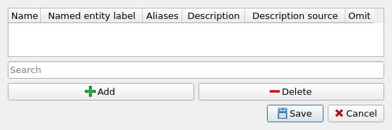

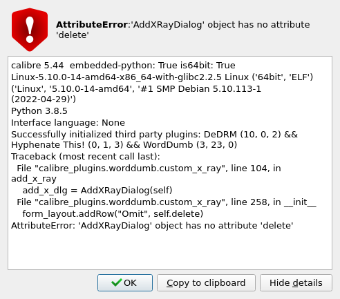

I downloaded and installed the latest Action.
When I click on customize xray, then click on the "+Add" button, I get an error.
ID:	194842   Click image for larger version
ID:	194843   Click image for larger version
Old 07-10-2022, 02:27 AM   #352
xxyzz
xxyzz ought to be getting tired of karma fortunes by now.xxyzz ought to be getting tired of karma fortunes by now.xxyzz ought to be getting tired of karma fortunes by now.xxyzz ought to be getting tired of karma fortunes by now.xxyzz ought to be getting tired of karma fortunes by now.xxyzz ought to be getting tired of karma fortunes by now.xxyzz ought to be getting tired of karma fortunes by now.xxyzz ought to be getting tired of karma fortunes by now.xxyzz ought to be getting tired of karma fortunes by now.xxyzz ought to be getting tired of karma fortunes by now.xxyzz ought to be getting tired of karma fortunes by now.
Posts: 450
Karma: 3000334
Join Date: Nov 2020
I forgot to rename that variable... It'll be fixed in the next GitHub Action artifact. Sorry for the inconvenience.
xxyzz is offline   Reply With Quote

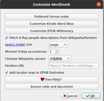

Thank you so much for your fantastic work. I have installed the plugin from GitHub, Action Artifacts, but I don't see any import option. Please let me know how the import option works.
samuelj is offline   Reply With Quote
Old 07-22-2022, 07:22 AM   #359
samuelj
samuelj began at the beginning.
Posts: 12
Join Date: Jan 2022
Device: Kindle oasis
Originally Posted by samuelj View Post
Hi xxyzz,
Never mind, got it. It is inside "Customize Kindle word wise". I will test it and let you know.
