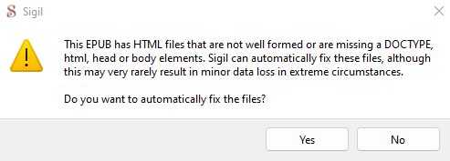

My personal choice is to use Sigil as my epub editor of choice. Opening a calibre generated epub with Sigil will result in an error message:
Name:	Screenshot 2022-07-01 124315.png
You can either hit yes here or run Mend and prettify all HTML files or Mend all HTML files from the Reformat HTML option in the Tools menu. Note that EpubCheck no longer returns a missing Doctype as an error.
So far doing that and making sure EpubCheck returns no errors has allowed me to test the email to Kindle without issue.
