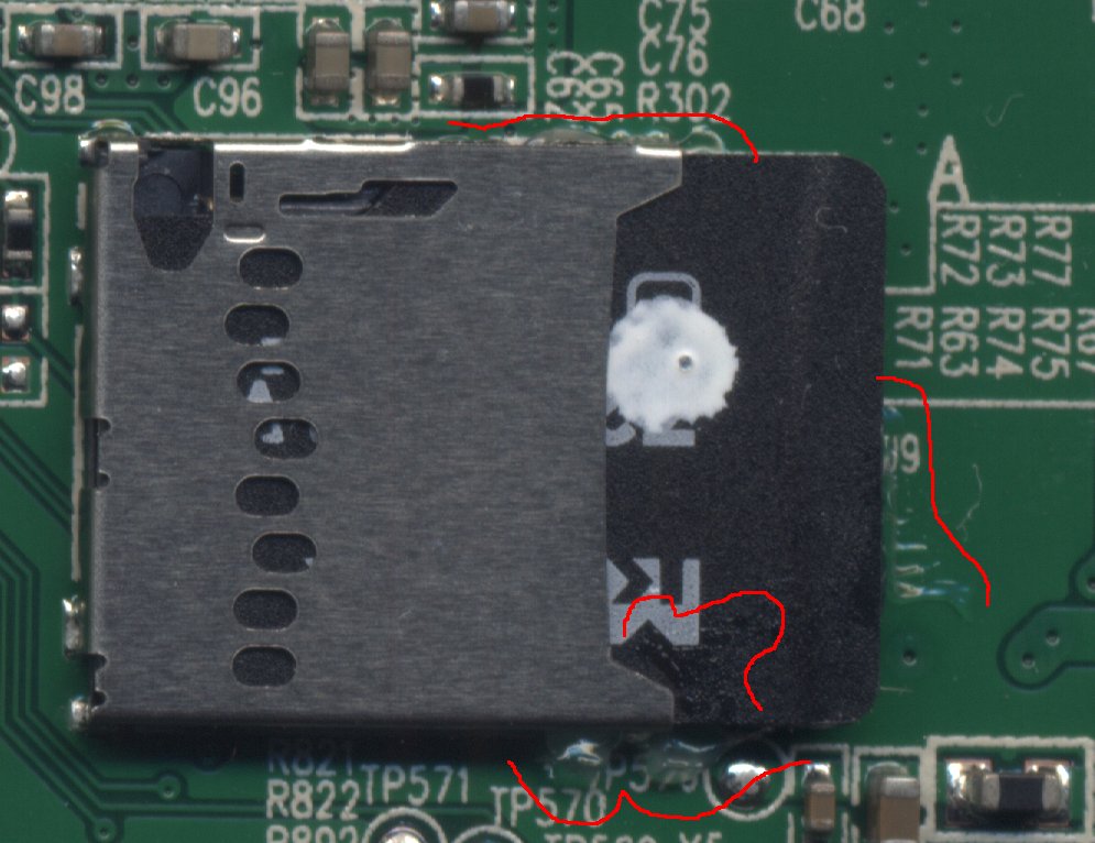

The Kobo Libra 2 microsd card turns out to be glued in all around, which makes it difficult to remove or replace. There is risk of damaging the slot when attempting to do so. Even putting a removed card back in might turn out to be difficult as there can still be leftover glue blocking the way (I didn't try it - decided to back off at this point). Unless you're very desperate you should consider this device to be like eMMC - non-removable storage.
Edit:
I'm not sure anymore if that was glue at all. it was dry on the outside, but turned greasy after moderately heating it, so it might be some kind of water-proofing gel instead. Unfortunately even after heating and removing most of the goop that I could reach around / above and under the card, it's still completely stuck.
Not sure what's the deal, whether it's simply stuck due to all the waterproof coating inside the slot, or whether it's actually soldered on or something. So might be it just needs a good tug or might be you'd destroy the microsd slot along with it, and that's not within my skills to repair, so I give up on it for now.
I've made a backup of the card so even destroying the card in the removal process would be an option if it left the slot intact... but I won't go in that direction until absolutely necessary.
If anyone else figures this out, please let me know. For now, I'm stumped.
Edit 2:
Someone managed to remove the card on a Tolino Vision 6 (separate line of readers which Kobo sells in Germany so it should be similar enough).
https://www.mobileread.com/forums/sh...89#post4171389
Note that one user also seems to have damaged their device in the process. Please be careful.
Edit 3:
Another disassembly attempt by LuQQ with pictures showing in detail how much glue there is inside the slot: https://www.mobileread.com/forums/sh...18#post4173818
Edit 4:
finally managed to remove it https://www.mobileread.com/forums/sh...22#post4213922
another Tolino user also reported success with a drop of WD-40 and tweezers

Originally Posted by frostschutz View Post
The Kobo Libra 2 microsd card turns out to be glued in all around, which makes it difficult to remove or replace. There is risk of damaging the slot when attempting to do so. Even putting a removed card back in might turn out to be difficult as there can still be leftover glue blocking the way. Unless you're very desperate you should consider this device to be like eMMC - non-removable storage.
A hair blower might do the trick. Soften the glue and remove. Just like when removing mobile phone back cases

I tried that and some soft stuff came out, which was quite un-glue like. Mabye there's a fat filling too...
All this for water proofing which I don't need or even trust anyway... sigh.
And if try to dissolve with ethanol?
It's a project for a different day, and maybe a different thread.

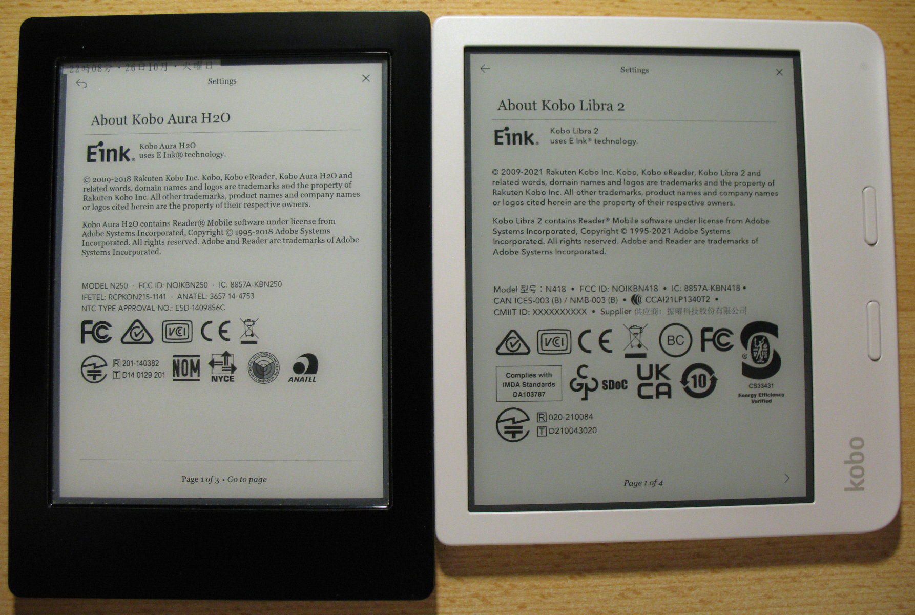

Back to first impressions.
It's really just a first impression since I haven't had time to actually read a book with the Libra2 yet (I've yet to set it up with fonts and everything), but apart from its gunky innards, I like it so far.
The display seems a shade darker than my 1st gen H2O. The H2O's infrared touchscreen is good for something, I guess. But with frontlight on, it makes no difference and the adjustable light color is nice, on the H2O you were stuck with whatever it looked like [I've seen H2O's with blue, white, and yellow light, there was some fluctuation there].
The difference in display size (0.2"-ish) is negligible, as for the higher resolution (265 vs 300 ppi) it remains to be seen. The Libra2 display is certainly much faster to update than the H2O's. They both have ghosting in menus and when typing Wi-Fi passwords and the like, though. EInk is still EInk.
I'll have to get used to the power button on the back, it doesn't seem to click or anything so you never know if you're holding it right or not (edit: I must have done something wrong yesterday, the power button works fine!). The structure on the back does not help much with grip. It's flat and smooth plastic, quite unlike the geometric-rubbery finish on the H2O. USB-C is nice, I'll probably use a different cable than the one Kobo supplied though, its plugs are on the bulkier side.
If there's a dedicated reset button (like the pinhole on H2O) I haven't found it yet. You can trigger a factory reset by holding power and page turn buttons simultaneously.
The H2O had an amazing display for its time, but I'm glad to have a white reader with buttons again, it's what I had with the iriver Story HD before the H2O. I'm hoping for the Libra 2 to show its worth in due time, and I haven't even touched the bluetooth functionality yet.

Join Date: May 2014
Device: Kobo Aura, Mini, Touch, Amazon Kindle.
i'd say it was more than a shade darker.
best wishes koboy
