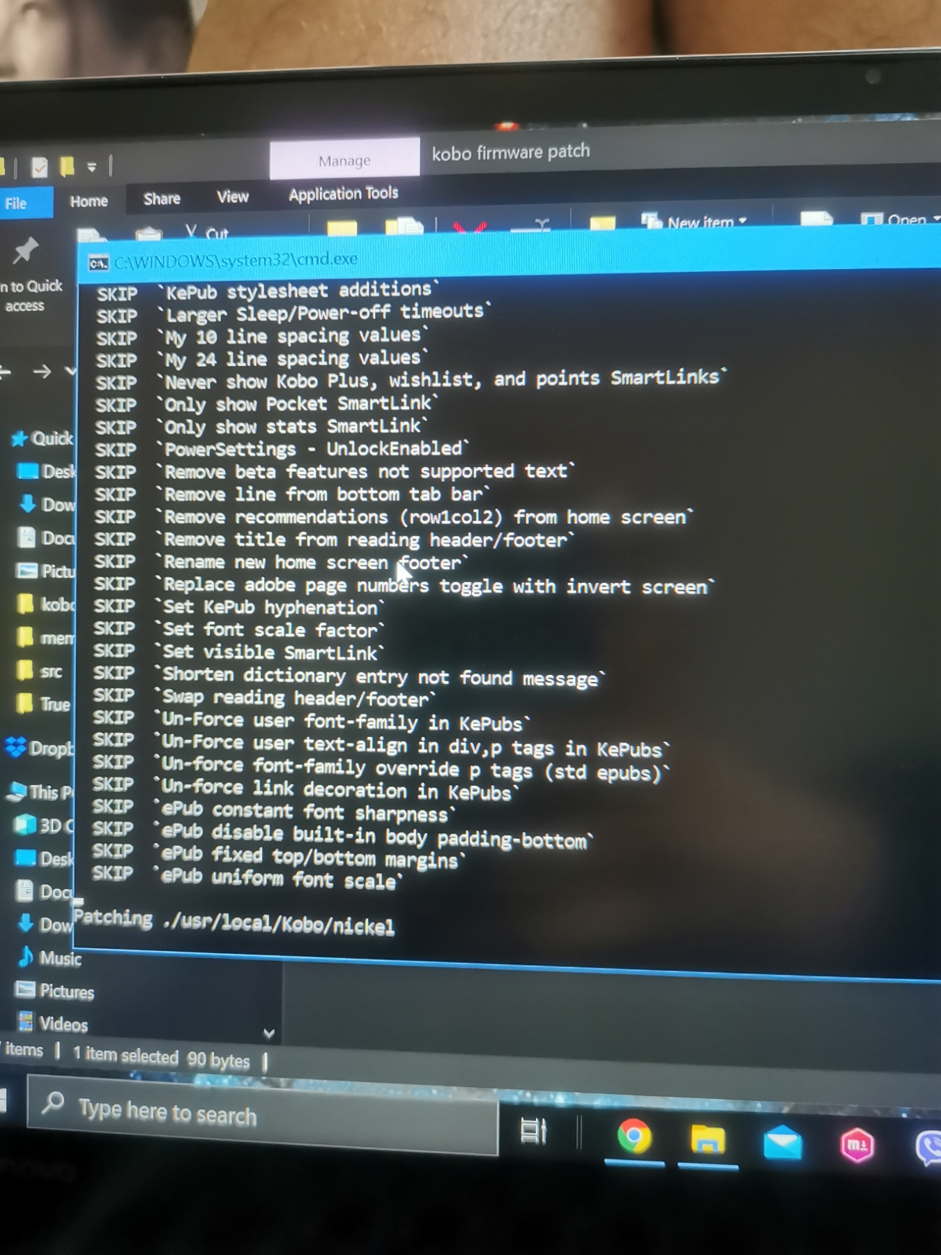

When I exucute kobopach it starts and close ... how to add code ?

Mio is offline   Reply With Quote
Old 03-11-2021, 09:13 AM   #28
Posts: 81,292
Karma: 150263711
Did you actually enable any of the patches?

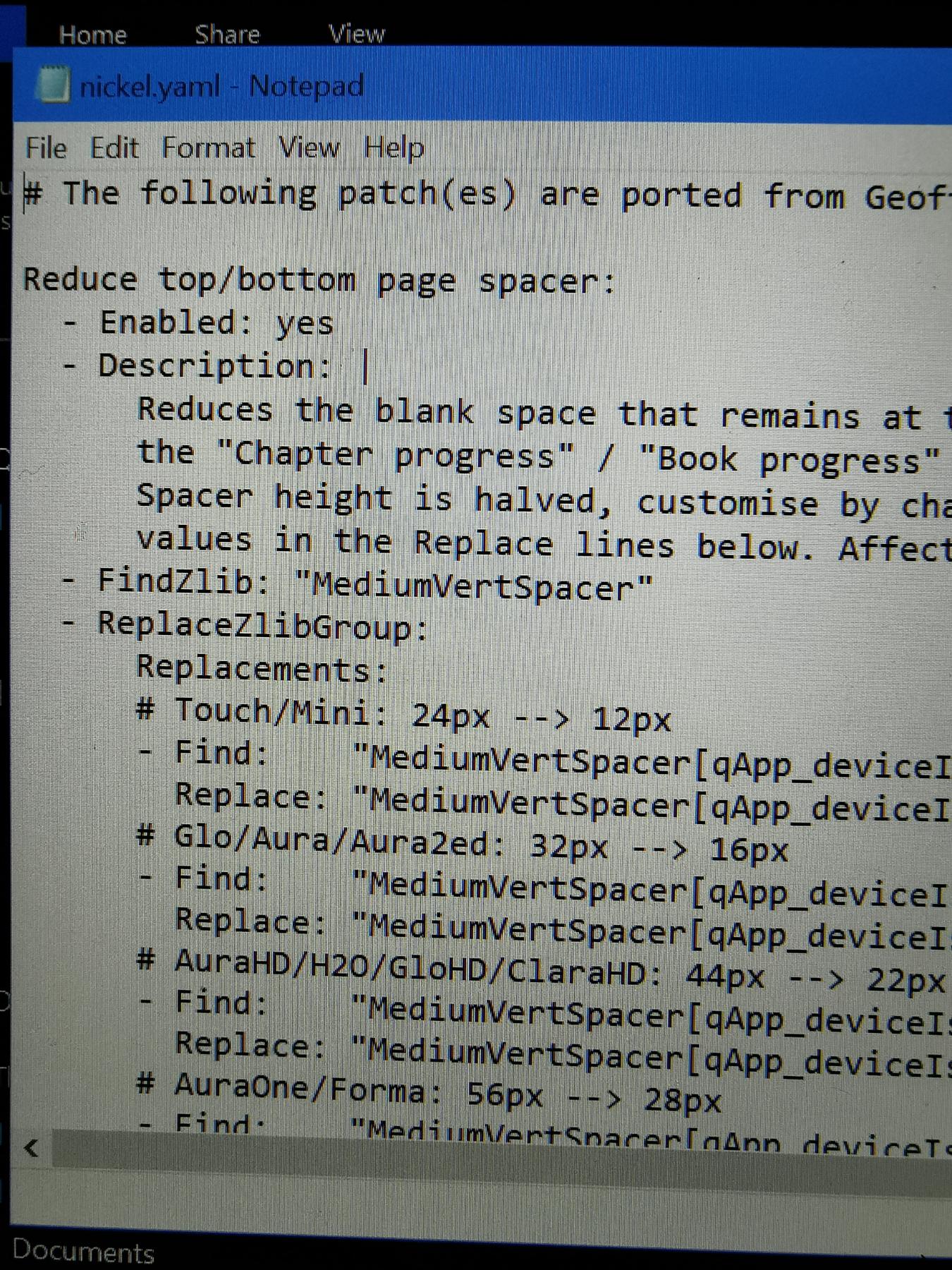

Went on nickel.yaml file inn Src folder and change all no to yes and save it ... after that I run .bat file ... but I do not get nothing in Out folder
I open file nickel.yaml in notepad , is that ok ?
