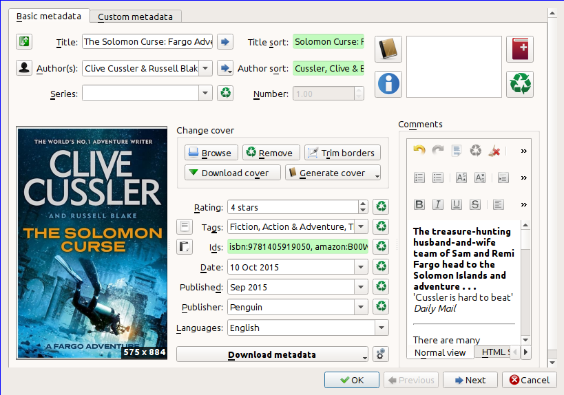

I dont see this, using the default metadata download sources of amazon.com (not amazon.es) and google. See screenshot.

For example when I look at the log for The solomon curse, I see two results from amazon, one of which does not have a language, and visiting that result's amazon page, shows that indeed, the language is not specified there:
http://www.amazon.com/Solomon-Curse-...rds=B010EW0LFC
