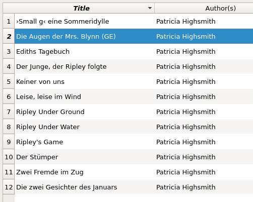

Adding terms to titles using Edit metadata in bulk
All books is to annex with Edit metadata in bulk a (GE)(stands for German Edition) like in Die Augen der Mrs. Blynn (GE).
I guess that is to achieve with regexes. I was busy for some time with them but don't get ahead.
Got several types of these makeovers.
HowToDo?

Old 03-19-2015, 01:03 PM   #2
Posts: 31,655
Karma: 64144480
Attachment 136173
I guess that is to achieve with regexes but I am not sure. Got several types of these makeovers.
I was busy for some time with regexes, but don't get ahead.
HowToDo?
Search mode: Regex
search: (.+)
Replace: \1 (ge)
Set Mode to Append to Field

The book Die zwei Gesichter des Januars show different results in the column Test result depanding of it is in line Your test or Book 1.
Name:	Edit meta information.png
It's my first time with regexes in action so allow me to consult you again.
I see that the test result is okay! The rest also?
Search field: title - otherwise nothing happens.

Old 03-19-2015, 01:55 PM   #4
Terisa de morgan
Terisa de morgan's Avatar
Posts: 6,759
Karma: 13151503
Location: Madrid, Spain
No, it's not OK. Don't use "Append to field" but "Replace field" in the Mode selection.

Yes! Now looks better.
The processing was okay. I thank you both!
Ah, one more question: Did I put in the Your test line something wrong? Was to insert something different than Die zwei Gesichter des Januars.
It irritates me that in both runs the Test result was OK.

Old 03-19-2015, 04:20 PM   #6
Posts: 31,655
Karma: 64144480
Attachment 136176
IMHO the test line is optional
It is useful for testing for unwanted side effects ( that might appear on longer inputs)
Acurate Test results is what you want. No unintended side effects showing
@Terise
I thought the OP wanted just to add a suffix
To be Honest ,
Why setting the Language to De is not the proper way for the German version?
(US English only reader <Some of the UK versions terms lose me>)
Old 03-19-2015, 04:39 PM   #7
Terisa de morgan
Posts: 6,759
Karma: 13151503
@Terise
If he only wanted to add a suffix, with Append Mode he would need (.+) => (GE) (Without \1). In the other way, he gets two titles (as it's shown in the picture).
To be Honest ,
I don't know (I set language too, and if I would like to see at a glance I would use column coloring or if I want to see int in the reader I would add the suffix in the plugboard, but everybody has his/her way).
Terisa de morgan is online now   Reply With Quote
Old 03-19-2015, 04:42 PM   #8
Terisa de morgan
Posts: 6,759
Karma: 13151503
Attachment 136176
Test result shows which is the replacement result for the first book, but no the final result in the field. Both searches are OK, as you don't change it, but the final result is different because you're changing the way that result goes to the field.
And sorry if it irritates you that it says OK if the search/replacement expression is right, when it is.

It is my considered opinion that pictures reveal often more than words, however, always they may serve to illustrate.
Optionality / longer inputs or not: The Test result in line Your test should show a correct result even it is the unwanted one.
(New example pics (Homer) for demonstration reasons.)
Name:	1 (GE) & Append to field.png
(.+) + \1 (GE) + Append to field
I don't know what are unintended side effects. If the final (processed) result is wrong any u.s.effects are unimportant.
Right, I wanted to add something, let's call it suffix (or adjunct). By name: (GE)
To be Honest ,
In my library there are books of different original languages but mostly translated to German. To see at first glance that a book with a German title isn't a originally in German written book I add (GE).
Let me present the advantages.
Name:	Ilias in 2 languages.png
It shows at a glance the Ilias in original language (without adjunct) and a translated version: Ilias (GE)
My calibre interface is German in order to understand you better in the forum if there is made reference to calibre interfaces.
Partly you are right. But see
Name:	(.+) & (GE) & Append to field.png
(.+) + (GE) + Append to field
There are (unwanted) commas in the Books -> Test results. Take also attention to the Your test result, a single (GE).
I admit to have considered the matter only under the premise of an adjunct. Column coloring or add the suffix in the plugboard you could represent a broad to show advantages. What's with this 'plugboard' idea right now I do not understand.
I see and be amazed. Either you make your CUT Wizard all respect or I see for nothing but results (let it be in tests, replacements, finals, searches or whereever) nothing anymore.
Fact is that only (. +) + \ 1 (GE) + Replace field results correctly so far.
In itself this would be enough. But it seems me that you yourselves still disagree about the different options. If such exist at all.
I look foreward to supply you with any Homer example images only the combinations for the Edit meta information window must be provided.
Last edited by chaot; 04-13-2015 at 06:46 AM. Reason: add :closed: / edit: It is my considered opinion that pictures reveal often more than words, however, always they may serve to illustrate. / trifles

Old 03-20-2015, 03:00 PM   #12
Terisa de morgan
Posts: 6,759
Karma: 13151503
@chaot, if you look at you picture, you'll see that you have a check near the "Append result", "Split result". If you uncheck it, the comma go away. If you play a bit with the fields you will be able to obtain your desired result.

Really fast. And correct!
In the Replace with field is to insert an space before (GE).
Even I can only reflect on your posts or play a bit with the fields - both is impossible
Name:	(.+) +  (GE) + Append to field + Split result uncrossed.png
The processing was OK.
Now we got 2 versions to result same!
(.+)|(GE)|Replace field|Split result crossed
(.+)| (GE)|Append to field|Split result uncrossed
Still the Your test line is a mystery to me.
Last edited by chaot; 03-23-2015 at 05:37 AM. Reason: add The processing was okay / add 2 versions / unpossibly→impossible / /→|

chaot is offline   Reply With Quote

That link discusses Search and Replace in the Edit E-Book feature.
Very different from Metadata Edit.
You want: http://manual.calibre-ebook.com/meta...ch-and-replace
