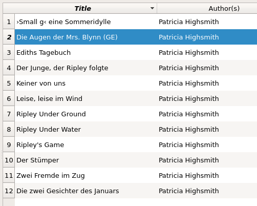

Adding terms to titles using Edit metadata in bulk
All books is to annex with Edit metadata in bulk a (GE)(stands for German Edition) like in Die Augen der Mrs. Blynn (GE).
I guess that is to achieve with regexes. I was busy for some time with them but don't get ahead.
Got several types of these makeovers.
HowToDo?
Attachment 136173
I guess that is to achieve with regexes but I am not sure. Got several types of these makeovers.
I was busy for some time with regexes, but don't get ahead.
HowToDo?
Search mode: Regex
search: (.+)
Replace: \1 (ge)
Set Mode to Append to Field

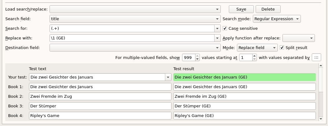

The book Die zwei Gesichter des Januars show different results in the column Test result depanding of it is in line Your test or Book 1.
Name:	Edit meta information.png
It's my first time with regexes in action so allow me to consult you again.
I see that the test result is okay! The rest also?
Search field: title - otherwise nothing happens.

No, it's not OK. Don't use "Append to field" but "Replace field" in the Mode selection.

Yes! Now looks better.
The processing was okay. I thank you both!
Ah, one more question: Did I put in the Your test line something wrong? Was to insert something different than Die zwei Gesichter des Januars.
It irritates me that in both runs the Test result was OK.

IMHO the test line is optional
It is useful for testing for unwanted side effects ( that might appear on longer inputs)
Acurate Test results is what you want. No unintended side effects showing

If he only wanted to add a suffix, with Append Mode he would need (.+) => (GE) (Without \1). In the other way, he gets two titles (as it's shown in the picture).

Test result shows which is the replacement result for the first book, but no the final result in the field. Both searches are OK, as you don't change it, but the final result is different because you're changing the way that result goes to the field.
And sorry if it irritates you that it says OK if the search/replacement expression is right, when it is.

@chaot, if you look at you picture, you'll see that you have a check near the "Append result", "Split result". If you uncheck it, the comma go away. If you play a bit with the fields you will be able to obtain your desired result.

Really fast. And correct!
In the Replace with field is to insert an space before (GE).
Even I can only reflect on your posts or play a bit with the fields - both is impossible
Name:	(.+) +  (GE) + Append to field + Split result uncrossed.png
The processing was OK.
Now we got 2 versions to result same!
(.+)|(GE)|Replace field|Split result crossed
(.+)| (GE)|Append to field|Split result uncrossed
Still the Your test line is a mystery to me.

That link discusses Search and Replace in the Edit E-Book feature.
Very different from Metadata Edit.
You want: http://manual.calibre-ebook.com/meta...ch-and-replace
edit metadata in bulk, regex, search and replace
