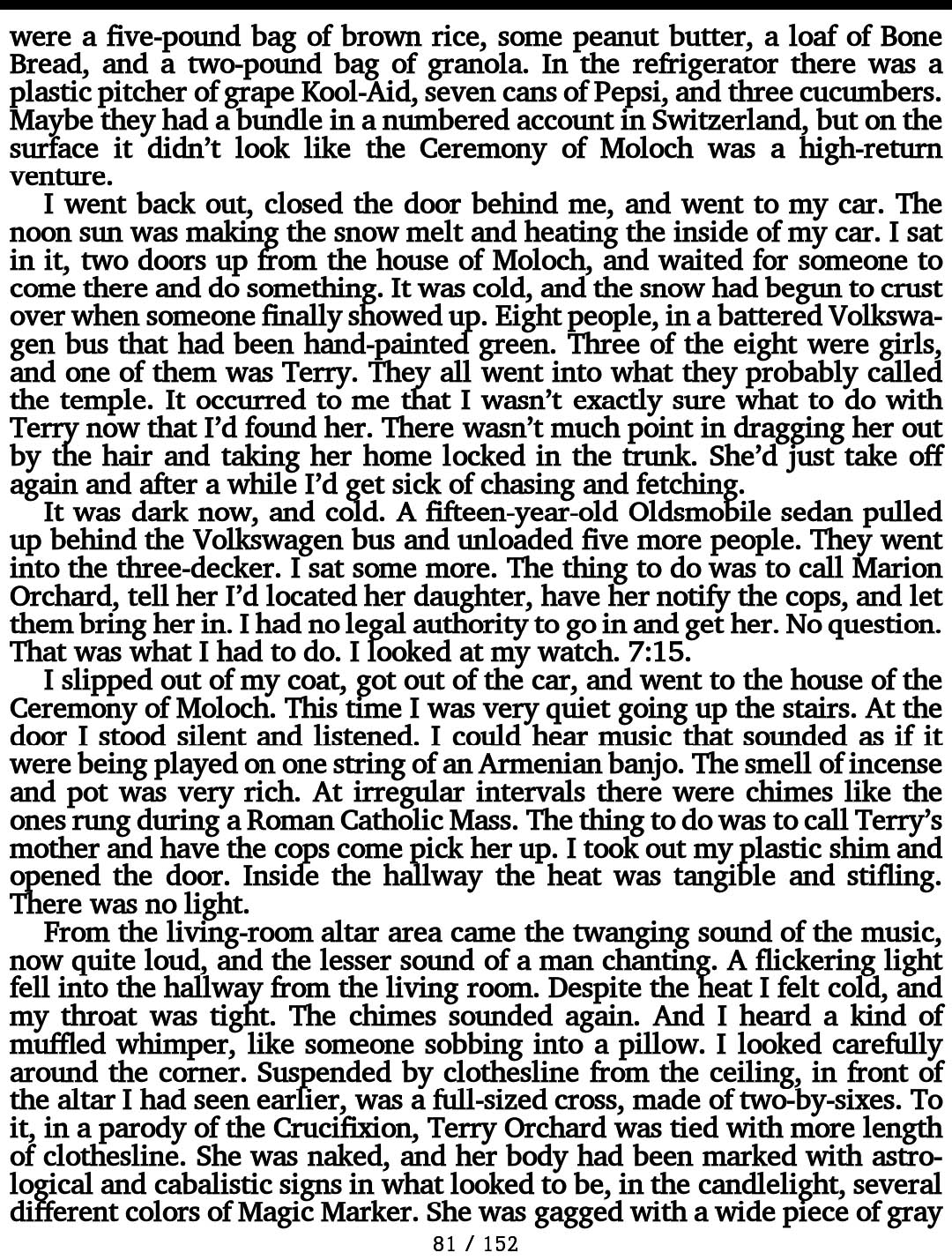

Here is the screen of my H2O using my footer setting in the post at https://www.mobileread.com/forums/sho...5&postcount=37
JSWolf, Could you let me know how you reduced(or hid) the top margin(Title) of page?

Old 02-07-2015, 12:48 AM   #164
Posts: 82,250
Karma: 150871427
