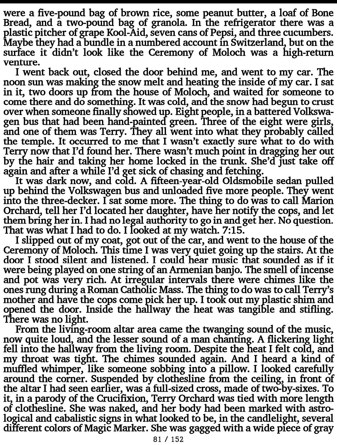

Here is the screen of my H2O using my footer setting in the post at https://www.mobileread.com/forums/sho...5&postcount=26

There is a little problem with Brightness fine control pacth
patch_name = `Brightness fine control`
patch_enable = `yes`
replace_int = 975B4A, 10, 01
replace_int = 975B7A, 10, 01
If enabled the patch on my h2o, There are certain values that i cannot control as controlling bar. I tried to change the value of the brightness to '29', but it shows the different value.
karamasova is offline   Reply With Quote
Old 12-09-2014, 02:15 PM   #40
doubleshuffle
Unicycle Daredevil
doubleshuffle's Avatar
Posts: 13,948
Karma: 185432100
Originally Posted by karamasova View Post
If enabled the patch on my h2o, There are certain values that i cannot control as controlling bar. I tried to change the value of the brightness to '29', but it shows the different value. also, it is same situation when i try to control as '58'. I think it doesn't apply not only the text, but also actual brightness on the device. exactly just for these 2 values. but not bad.
That problem has been around for so long that I might actually miss it if it went away...

<Patch>
patch_name = `Custom footer`
# Changes the footer text with something shorter
# (not sure how it affects translations)
replace_string = D1BCE8, `Page %1 <i>of</i> %2`, `%1 / %2`
</Patch>
Can we make the footer text aligned to the left?.....
I tried adding a text-align: left; property to the Custom reading footer patch, with and without !important;, but it doesn't have any effect.
It might still be possible, but it is not obvious how to do it.
Old 12-14-2014, 10:09 AM   #45
Posts: 82,246
Karma: 150871427
I have never seen a footer for a Reader be anything other then centered. I'm not saying it's not possible to do it any other way, but unless the code to change is obvious enough, it won't happen.
